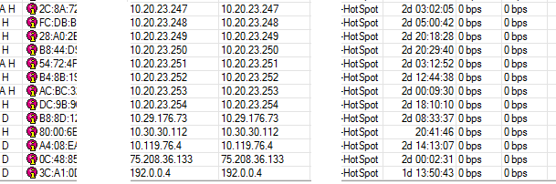

From time to time some rogue devices will connect to the hotspot with a different IP that doesn’t match the guest network flagged Dynamic. How is this happening, are this devices setup with a static IP?
IP>Hotspot>Hosts
The problem begins when one of those guest devices are set with the same IP as those in the office network. The device in the office network will not be able to access the internet, because it’s IP matches the one in the Hotspot Hosts list.
It doesn’t matter if the rogue device connected for just a second, because the idle time will keep it on the list until it expires. In the mid time, the user in the office network will not be able to access the internet.
