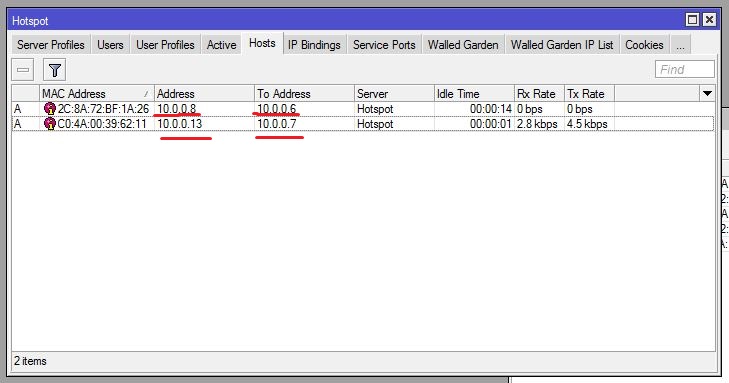

i am using hotspot as you can see and i am wondering if this is a problem or this is how hot spot works.
as you can tel from the pictures i am having 2 ip’s per device i from DHCP and other from hotspot.

it’s not really an issue. the hotspot is doing what you tell it to do.
if you only want the DHCP adress, change the Address Pool to None, Hotspot → Server and also User Profile
you will have one address.
