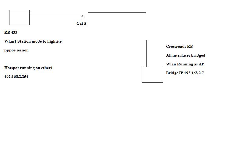

Here’s a diagram.
Here’s the hotspot controller
Here’s the remote AP.

Okay, just to make it a bit more interesting, i am not making use of eoip tunnels, i have a lan connection between 2 routers.
