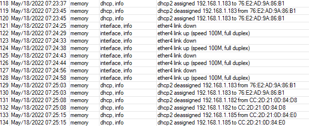

When I setup a hotspot (using hotspot setup) on the interface that goes to one of Tenda router, the hotspot is working erratically.
Meaning it would log-in,… and then internet connection suddenly stops.. wifi disconnects… and then reconnects again.. slow speed. or something like that.
I checked log and it ALWAYS have this kind of error.
How can I fix this?
Is this a possibility of bad router? (however router had no problem at all if connected to mikrotik not in a hotspot mode)

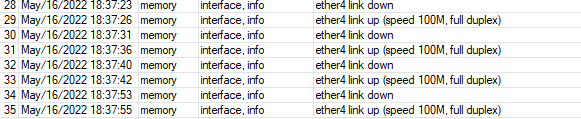

If I set the wifi router back to BRIDGE mode, suddenly:
