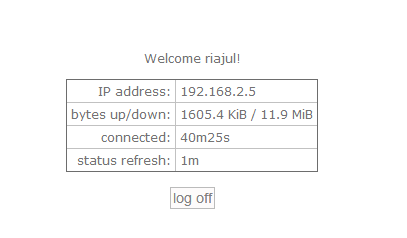

hello,
i have hotspot setup my RB450 . i have made binding for my ip 192.168.2.3 , but if hotspot login then it giving me different ip 192.168.2.5. also i have DHCP on my router.
please see attachment.
i need if i login then it will remain address 192.168.2.3 not 192.168.2.5
please help me with this.

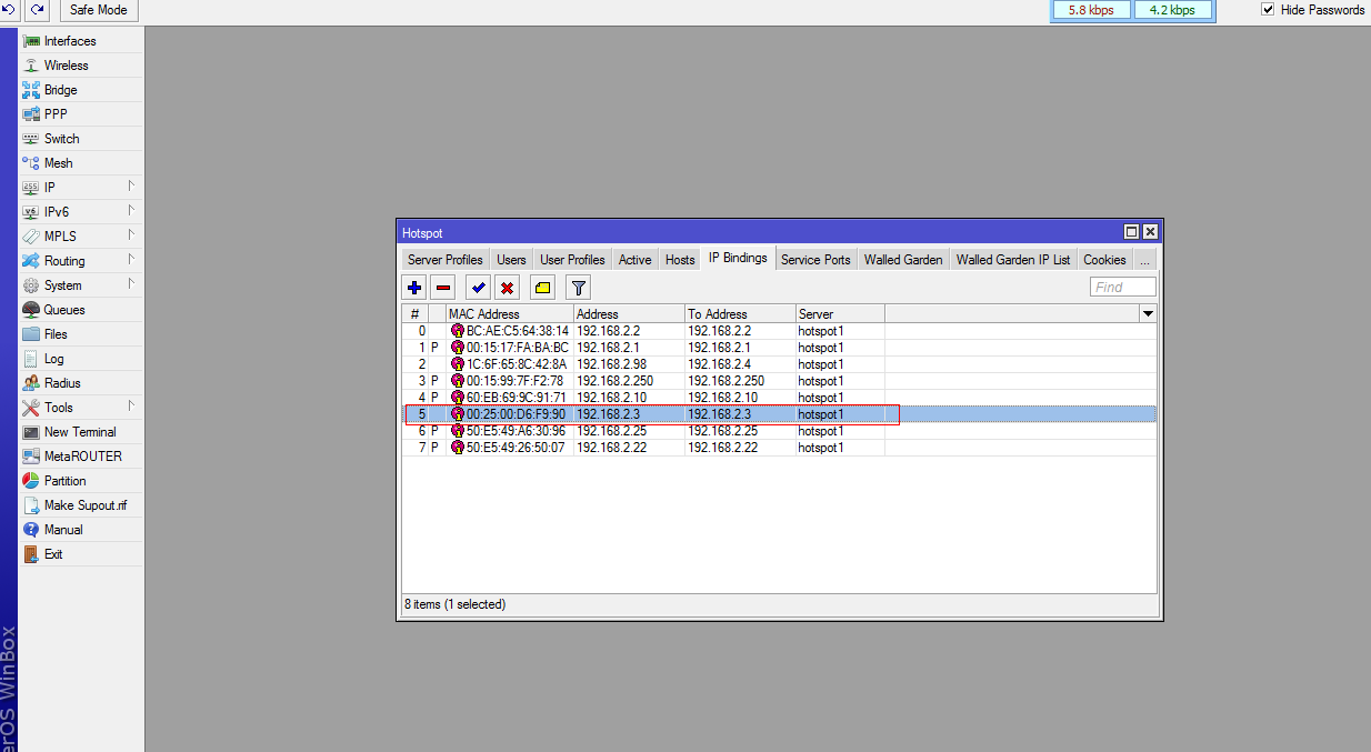

i made static already which i want to lease. before hotspot login its giving address to address same, but if i login hotspot its giving different.
more clear to you that i have admin pool address from 192.168.2.1-192.168.2.20, i have lease my computer ip 192.168.2.3. also i made binding my ip 192.168.2.3 to address 192.168.2.3 which i shown my screen shoot. when i loging to hotspot i should get ip 192.168.2.3, but i am not getting that. i am getting 192.168.2.5 or 192.168.2.9 or something from pool 192.168.2.1-192.168.2.20. i have checked that if my ip was taken by any hotspot user/host. but no, none taken 192.168.2.3.
hope i made you understand my problem.

just empty (0.0.0.0) the address and only fill the to-address (192.168.2.3) of the mac-address in the ip-binding
tried no solve :frowning:
