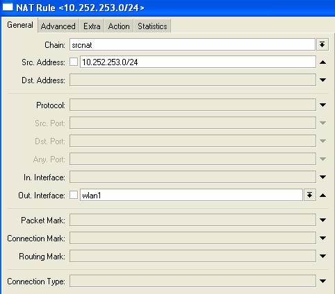

And also the masquarade rule

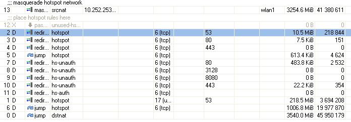

Just the one static NAT rule + a whole bunch of dynamic rules put in by the Hotspot service
NAT RULE:
add action=masquerade chain=srcnat comment=“masquerade hotspot network”
disabled=no out-interface=wlan1 src-address=10.252.253.0/24
My Backhaul uses a non standard proprietry form of 80211n Is is secured with MAC authorization and WPA encryption I know anything is hackable but we are talking about silver surfers here as the network covers a retirement village. :slight_smile:

Here is the challenge:
Remove the src-address entry. It does not masquerade any 192.168.x.x addresses.

Ok well I removed the source address in the masquerade NAT Rule in the AP
add action=masquerade chain=srcnat comment=“” disabled=no out-interface=
ether1
Stupid Question, I am correct in assigning the out interface as ether1 ? and you where talking about the AP not the Client CPE
Unfortunately the problem is still present
As you can see the Hotspot has picked up an IP from the connected Clients CPE LAN side ???
