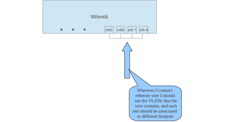

Hi. I’m trying to associate a different Hotspot to each VLAN that I create. That configuration has a pecularity, indepently the port where the ethernet wire is connected all the VLANs have to be available. To obtain that, I’ve created a bridge that contains all the ethernet ports and I created 2 VLAN’s and associate them to the bridge.
That configuration works properly if there’s no hotspot enabled. When I create the hotspot servers and associate them to each VLAN, I lose internet access and the redirection to the login page doesn’t work.
Any suggestion about what’s happening? (I’ve attached a sketch to clarify the situation)
