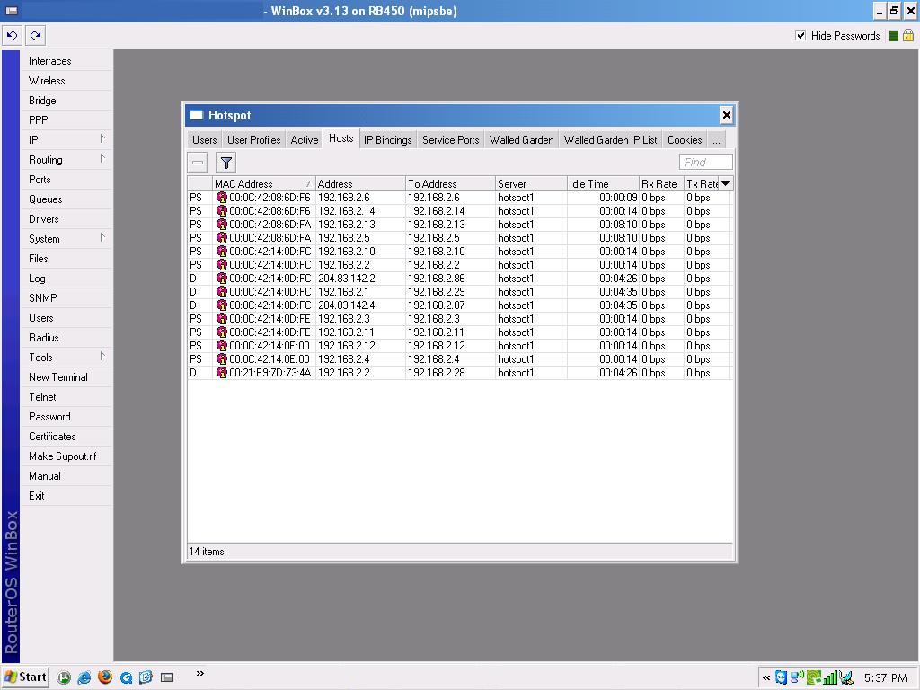

Thanks for the reply so quickly. I read a document a week ago in regards to your response so I had tried changing the address-per-mac to 250 and this didn’t make any difference, although in theory it should have corrected the problem, I have a screenshot of the host window and you can see the MAC’s of my AP’s only with multiple IP’s that correspond to those MAC’s. Not to confuse annyone, the host tab is showing the IP of both the AP’s and clients, now the AP is showing up with the IP for WLan interface as well as Ether1(192.168.2.1 is the same AP as 192.168.2.10) both interfaces are in the bridge,just to clarify things. Like I said 5 AP’s in total here, along with a few clients listed. Maybe this is normal but I thought I would post the shot to have a better idea of what i am talking about.

What ip and netmask is assigned to the hotspot interface? If I was setting this up, then it looks like it should be 192.168.2.1/24. But if that is true, then you have duplicate ips on the net. The hotspot interface and 00:0C:42:14:0D:FC have the same ip. That would not be good. How did that device get that ip?
ADD: The “D” preceding the mac is the hotspot saying “this was dynamically issued, but not by me”.
