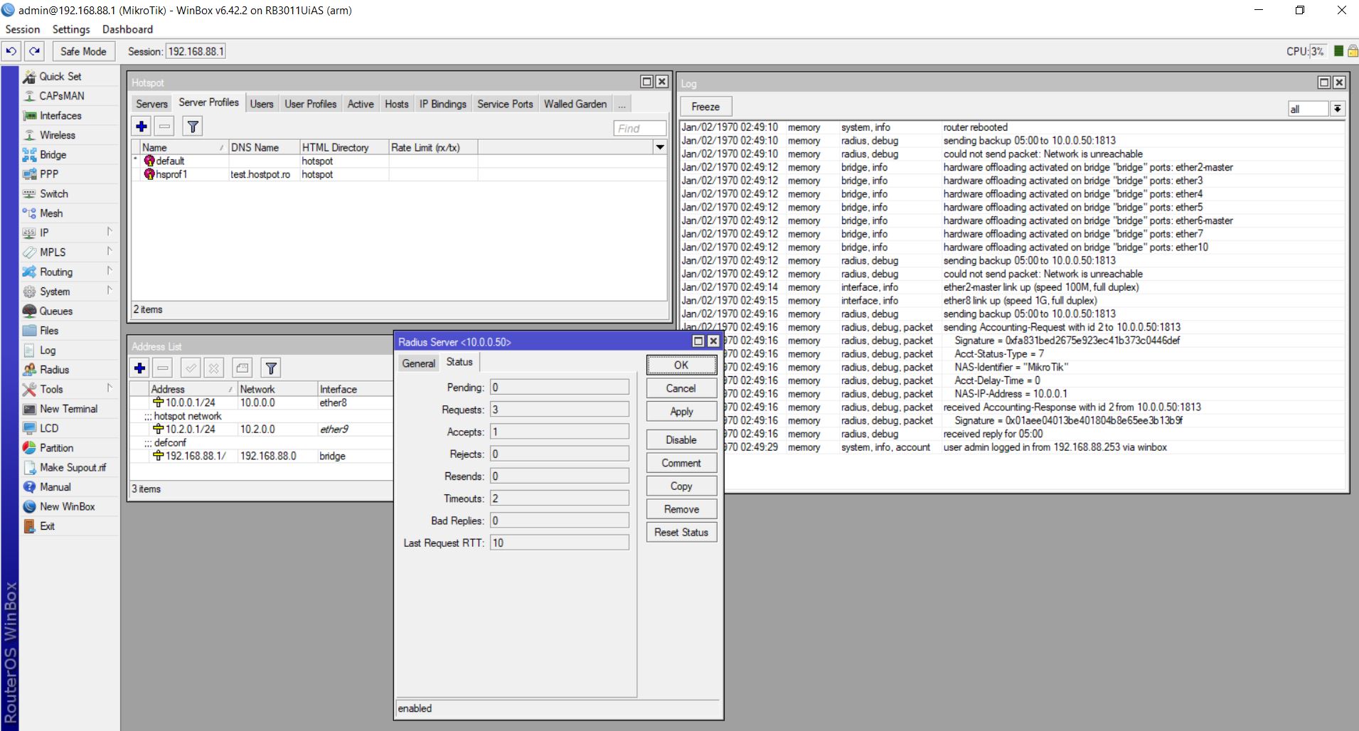

During the booting phase the Router is sending 3 Accounting Packets, see the log. 2 are lost due to interface startup process, 1 is successfully send to the radius server, how is shown in the log below:

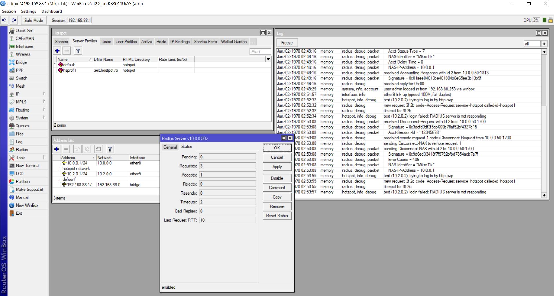

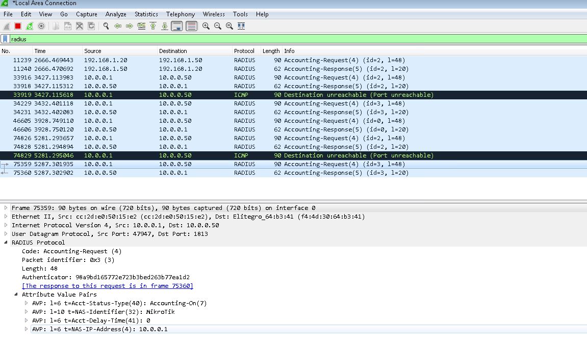

When I try to log in on hotspot, I receive the log: “login failed: RADIUS server is not responding”, but the log is not showing that the router built any radius package, it is not showing that it send any request to the server, the server statistics are not incremented.
To test the connectivity and functionality I forced a CoA request from the server to the router and the router is receiving the packet, see the log below:
