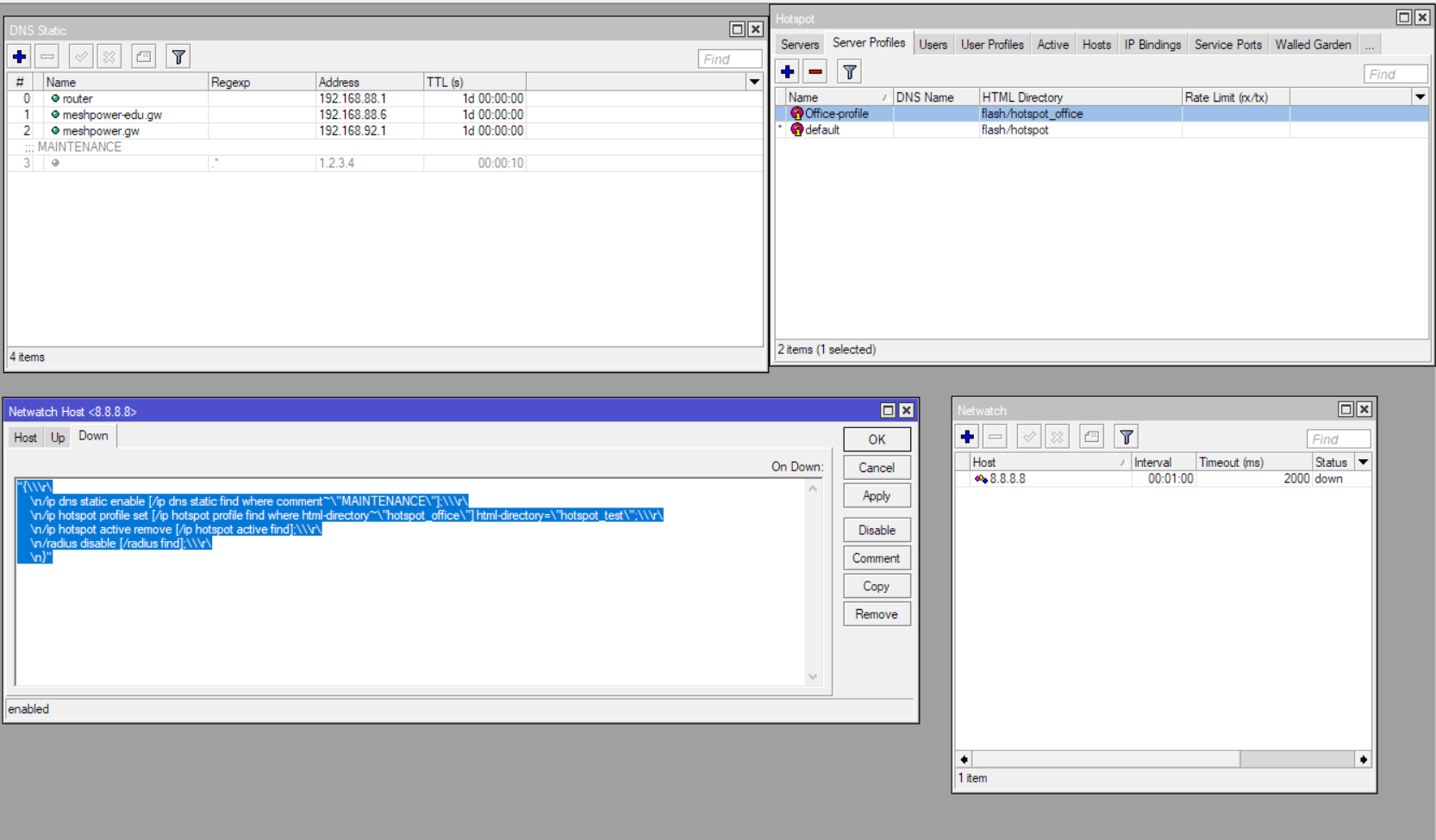

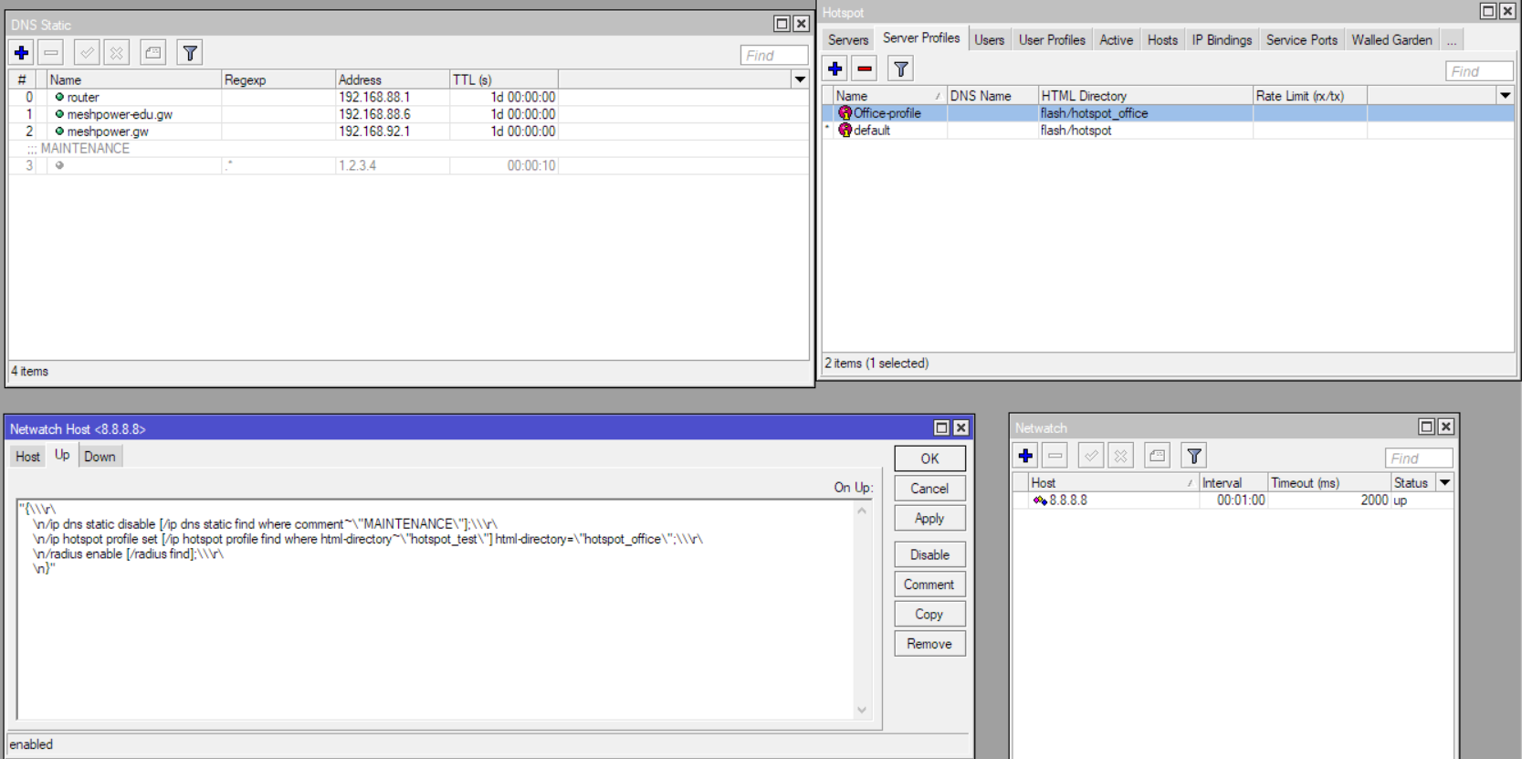

I am trying to implement your solution now, but it sees that down/up scripts are not working.
I have two folders: “hotspot_office” - when internet is working and “hotspot_test” when ISP is down. However the html_directory as well as dns are not changed when ISP goes down.

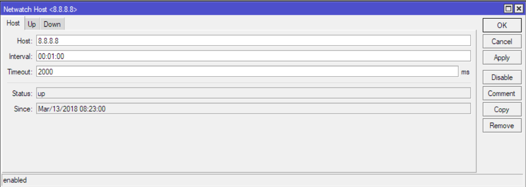

Please see my screenshoots:
Netwatch host:
When ISP is down:
ISP up:
