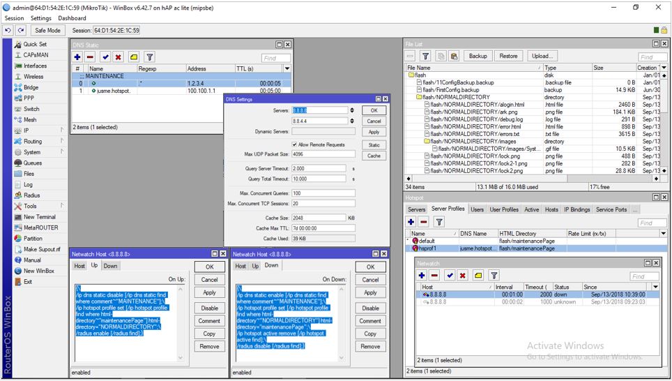

Did you copy paste the script into the terminal or did you use Winbox? There are too many escape characters
The DOWN script should be:
/ip dns static enable [/ip dns static find where comment~"MAINTENANCE"];\
/ip hotspot profile set [/ip hotspot profile find where html-directory~"NORMALDIRECTORY"] html-directory="maintenancePage";\
/ip hotspot active remove [/ip hotspot active find];\
/radius disable [/radius find];}
The UP script should be:
/ip dns static disable [/ip dns static find where comment~"MAINTENANCE"];\
/ip hotspot profile set [/ip hotspot profile find where html-directory~"maintenancePage"] html-directory="NORMALDIRECTORY";\
/radius enable [/radius find];}

Quite simple, as @rextended said, the browser still needs to be tricked that internet works.
The first thing that the browser do is a DNS request to resolve the domain (IE www.mikrotik.com) and then initialises the connection to the corresponding IP address. That connection can be intercepted by Hotspot and therefore the maintenance page is prompted.
The TTL of 10s will ensure a quick clearance of the fake DNS resolution as soon as the internet connectivity is back.
With the latest ROS versions you can use the internet-sensing feature instead of netwatch but I didn’t manage yet to test it.

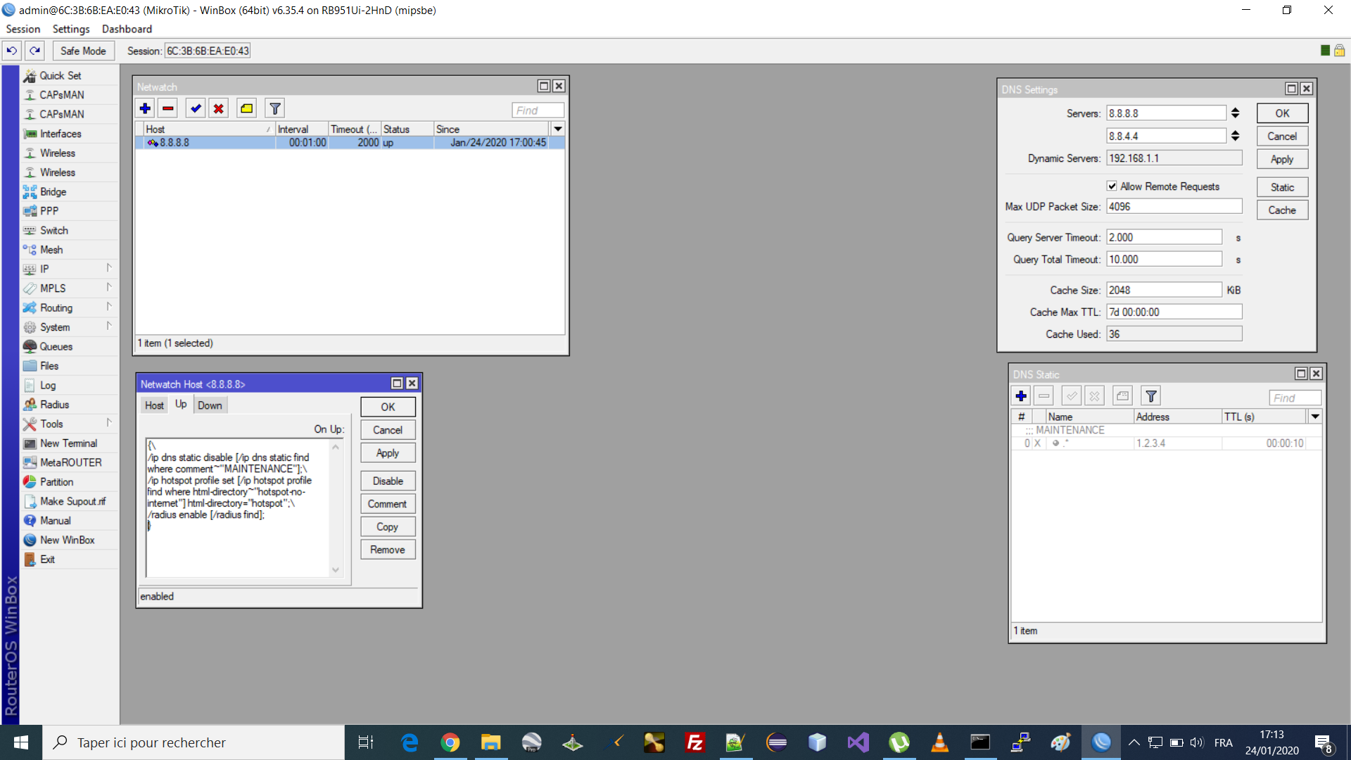

Hello everyone,
I know that the subject dates from more than 2 years but I have the same problem I tried to apply the method of Muqatil but without internet I am not redirected automatically
the DNS redirection does not work for me, i just try it again by making a reset on the router and fresh start it, and when the Redirection is on, on an iPhone show that “Unable to open webpage, to many redirections” (is in spanish so im not sure if it says the same on the english version, im translating it) Im running rOS 6.46.2 on a RB951Ui-2HnD
