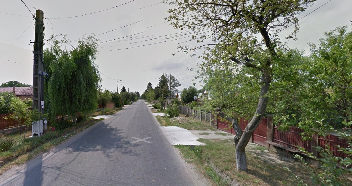

The area where I would I to implement this is a straight line (described like this):
  • It’s a village
  • 6km long
  • On the middle is a street 6 m wide.
  • At 10m from the middle of the street are usually tall trees (both sides).
  • At 20m-30m from the middle of the street are houses build form bricks(both sides).
  • In the middle of the village the is an uplink with optic fiber.
What I intend to do is to provide wifi network to potential users that can sustain 100-200Mbps traffic (inside their houses).
Until 5Ghz I don’t need special approvals.
Can anyone give me some hints about this? I don’t need a project, just a starting point.

In the attached picture, if you would chose one of the Mikrotik wifi products, and put it in the middle of the road at 4-5 m height, what range would we cover for 100-200Mbps and how many users will be able to connect through that product with that speed? We will assume that the specific product already have an uplink that support the traffic.
