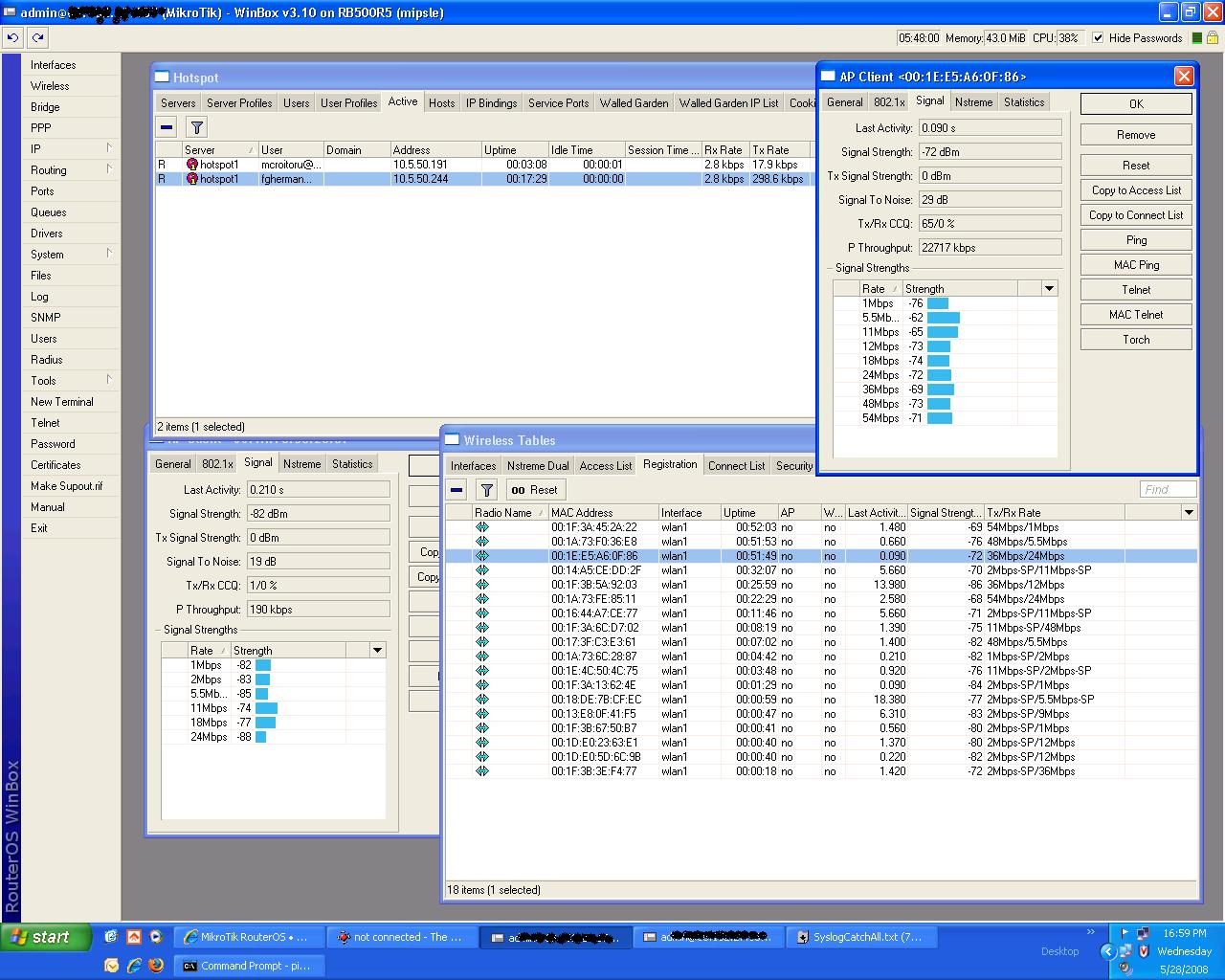

Hotspot no bandwidth on RB532 v3.10 mipsle
RB532 configured as hotspot. Bandwidth on an ethernet port is as expected (>5Meg) with provided backhaul. Bandwidth on WLAN is 300 - 500k at best. Have tried toggling transparent proxy, as suggested in another thread, to no avail. Have wiped and reconfigured from scratch - started with v2.9x with same results. Screenshot attached showing what look like acceptable CCQ and noise when moving traffic. Full export also attached. At our wits end! Thanks. Ed.

Looks like too much radio noise in the air. Have you tried moving to different channels? ccq of 65% is not good. You want it closer to 100%.
Tom
