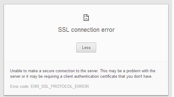

Thanks for your response,
I have attached an image of the error which I get,
However I dont think that having an ssl cert on the hotspot is the issue?
This error doesnt occour when I try got to my hotspots page using ssl.,
If I connect to the wireless, (Not Logged in) and My browser automatically goes to https://youtube.com I get this error attached. BUt it doesnt even try redirect me to hotspot.local ?
Unless I require a ssl cert in order to even redirect an https request?
Srange behaviour. Kindly attach your config.
