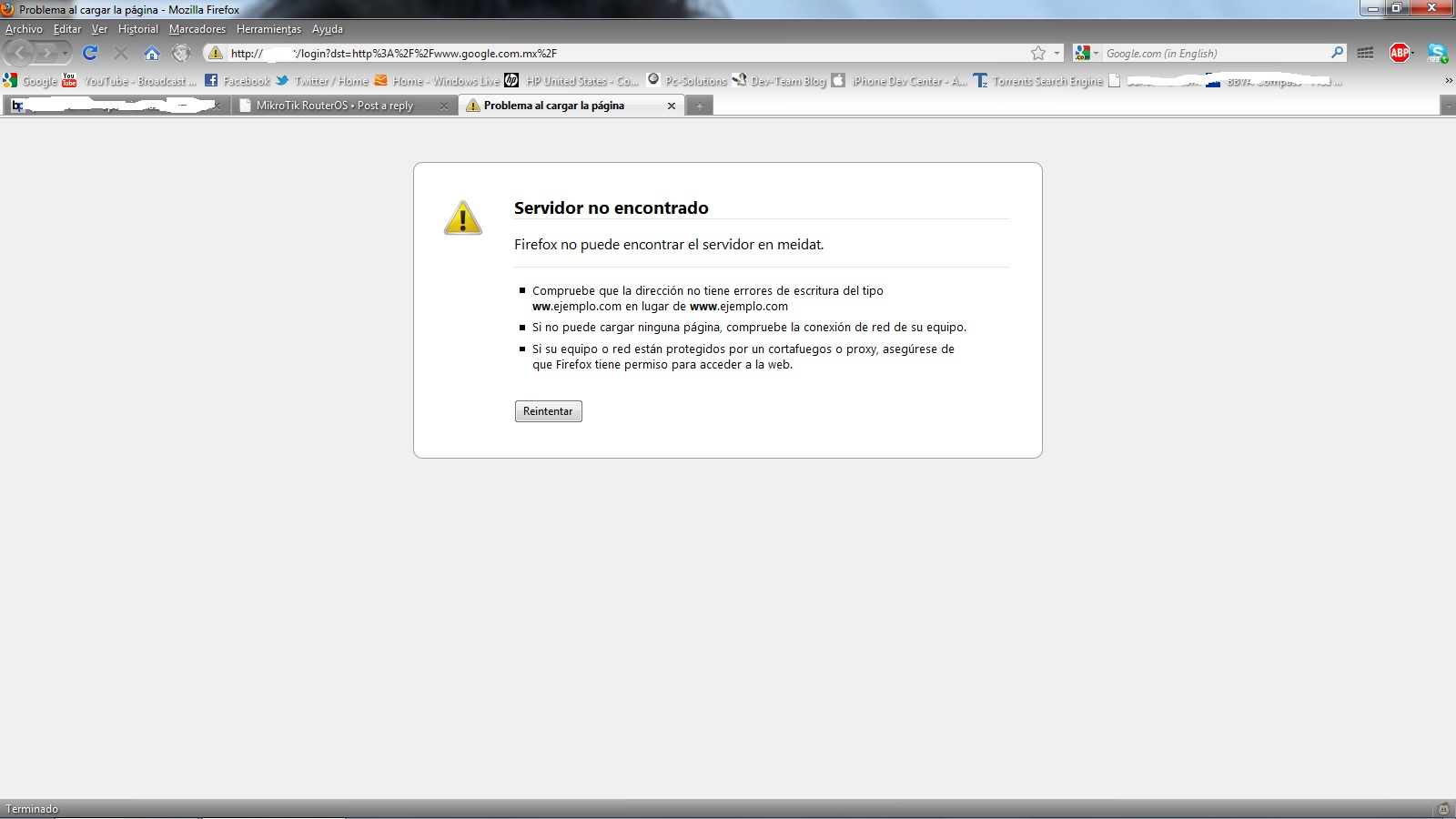

This is what i get if i try to connect with a pc, but for example with an Ipod i can connect without problem
Unfortunately you blocked out the most important part. What DNS name did you give the Hotspot instance? Different OSs may have different resolvers that may throw faults on different RFC incompatible names.
