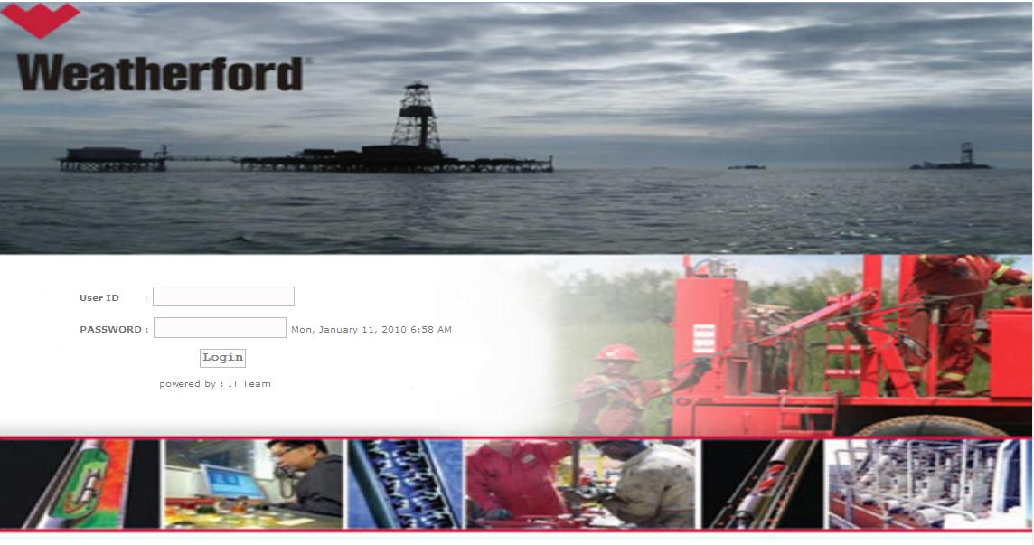

guys it is impossible to provide me hotspot page template like crystal login page and I will do some change on it please I need to change my hotspot page and make a new page for our company .

fewi I have some experience about the design but I need a simple page and I will do edit on the page . I have attached pictures for you to see which design I needed

reinerotto I designed the page but I don’t know from where can I get the username and password code

  1. install and enable Hotspot in your RouterOS router
  2. download the Hotspot folder from the Files folder
  3. Edit the Login.html page
The default login page is as good a template as any
normis I fnish every thing and I designed hotspot page and the page ready but my point here!!! how can I upload the new hotspot page in a Hotspot file in FTP
normis your advice
Make sure FTP is enabled under IP/Services. Make sure you’re permitted by the firewall to access the router via FTP. Open the router IP in an FTP client and provide a username and password permitted FTP access. Find the folder that your Hotspot profile names for the HTML files. Upload files to that folder.
