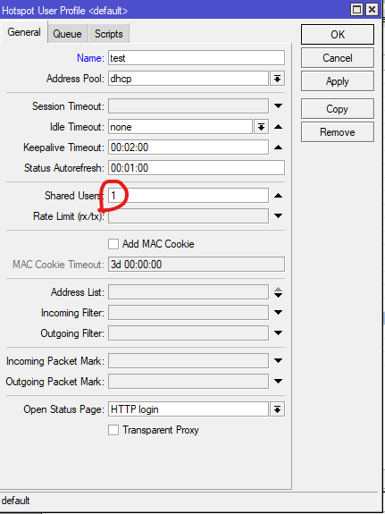

i have a mesh wifi Access Point (Tenda Nova Mw6) plugged in to port 2 of my hEX PoE router, if there are 10 devices connected to that AP
and 1 of them have been logged in using 1 account, all of 10 devices will be automated logged in. So these devices are using 1 hotspot account, hence i have set the share user value to 1 in user profiles
any solution for this ?
