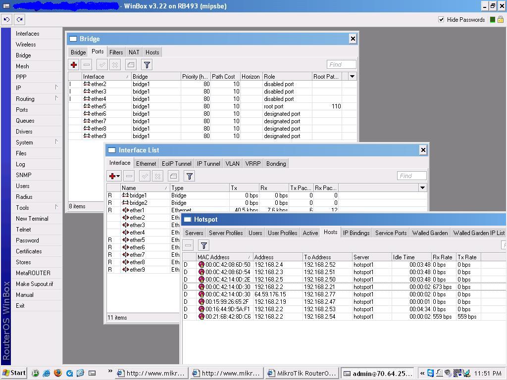

I am trying to sort out some problems with a newly created hotspot server, as you can see from the screenshot below under the ‘hosts’ tab, all AP’s(192.168.2.2,3,4 and 5) are showing up as “D” flags, I have not yet setup binding but will soon, even so once I have done this I dont understand why other host have the ‘D’ flag as well, sometime 2 clients are able to login and become ‘AH’ but they seem to loose the connection after a few minutes, this tells me that i have not properly setup the hotspot but would like to know what i might be doing wrong, I would like to see ‘H’ and not ‘D’ flag showing up, then it should work fine! Any suggestions are truely welcome and appreciated.

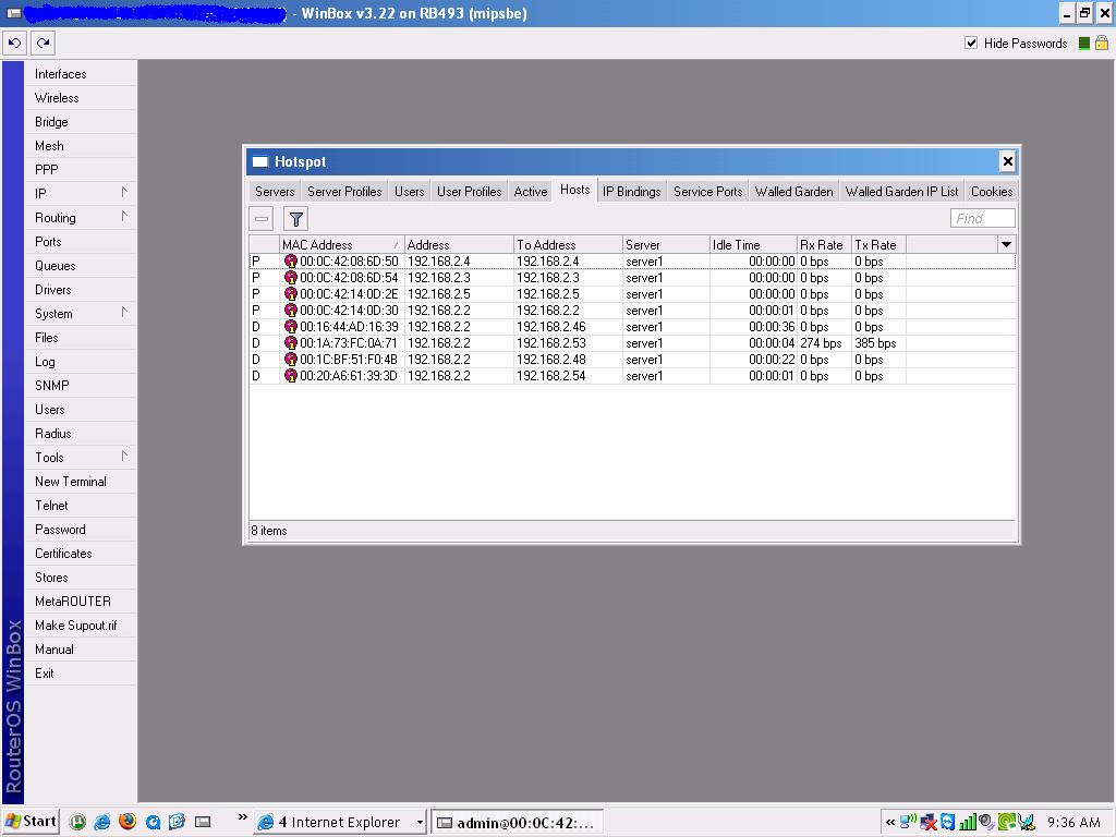

As you can see the Master AP(192.168.2.2) that has ethernet wired to it from the RB493 is showing up in the hosts multiple times, I have tried up’ing the ‘addresses per MAC’ this has not changed anything, you can see below I have binding setup for the 4 AP’s, and I am still seeing the ‘D’ flags for clients, telling me that the Hotspot does not know where these clients are coming from, correct?
Thanks for your input people.
