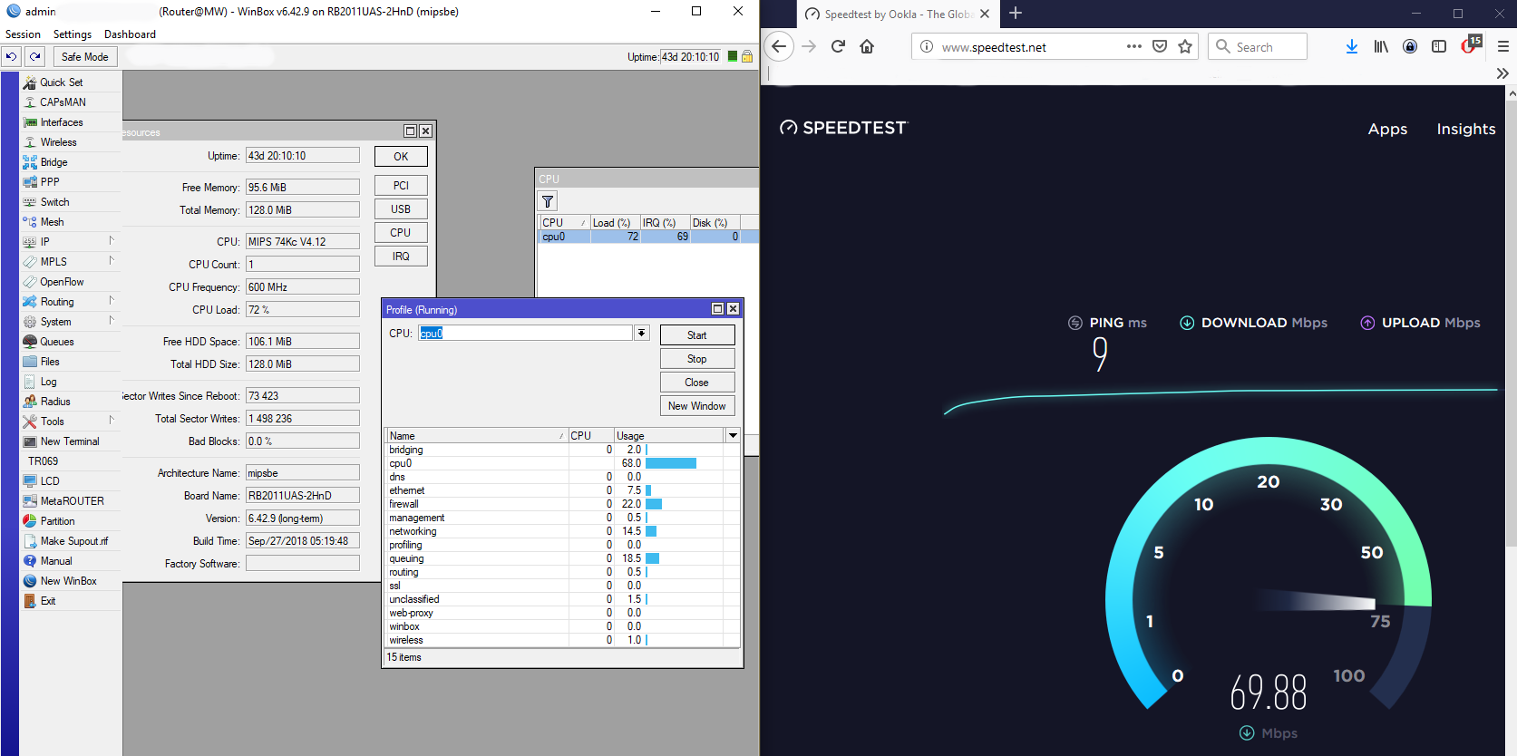

At the default settings from the autoconfiguration of HotSpot my internet connection it’s slower.

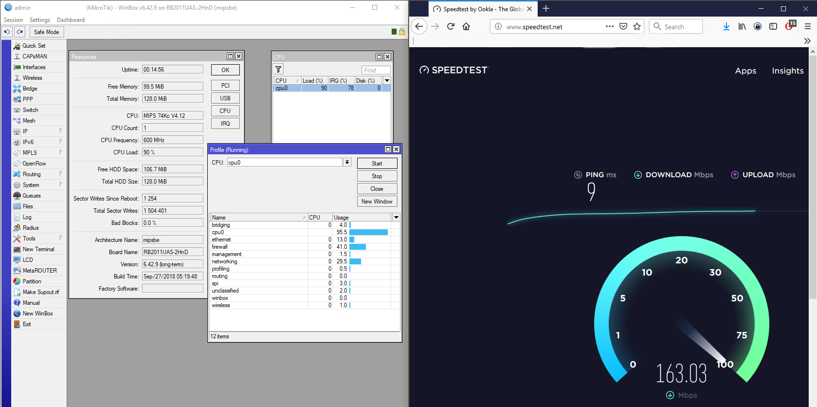

Doing measurement by speedtest.net it always fluctuates on the level 70-80 Mbps of Downloading - CPU usage jump to 75-80%

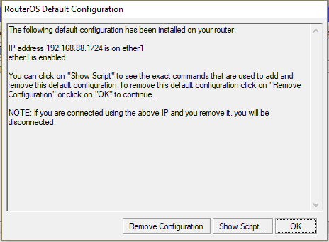

When I reset configuration and start Mikrotik with default configuration (at the start window with information if I want clean configuration or standard/default)
and I will once again do a speed measurement by speedtest.net the tip shows 180-200 Mbps of Downloading

You can have a look under System > Resources > CPU, run a profile and you’ll see where all the resources are going.

Look on screenshots:
  • ss-hotspot.png - it’s with Hotspot enabled
  • ss-default.png - it’s with default configuration (default configuration.png)
