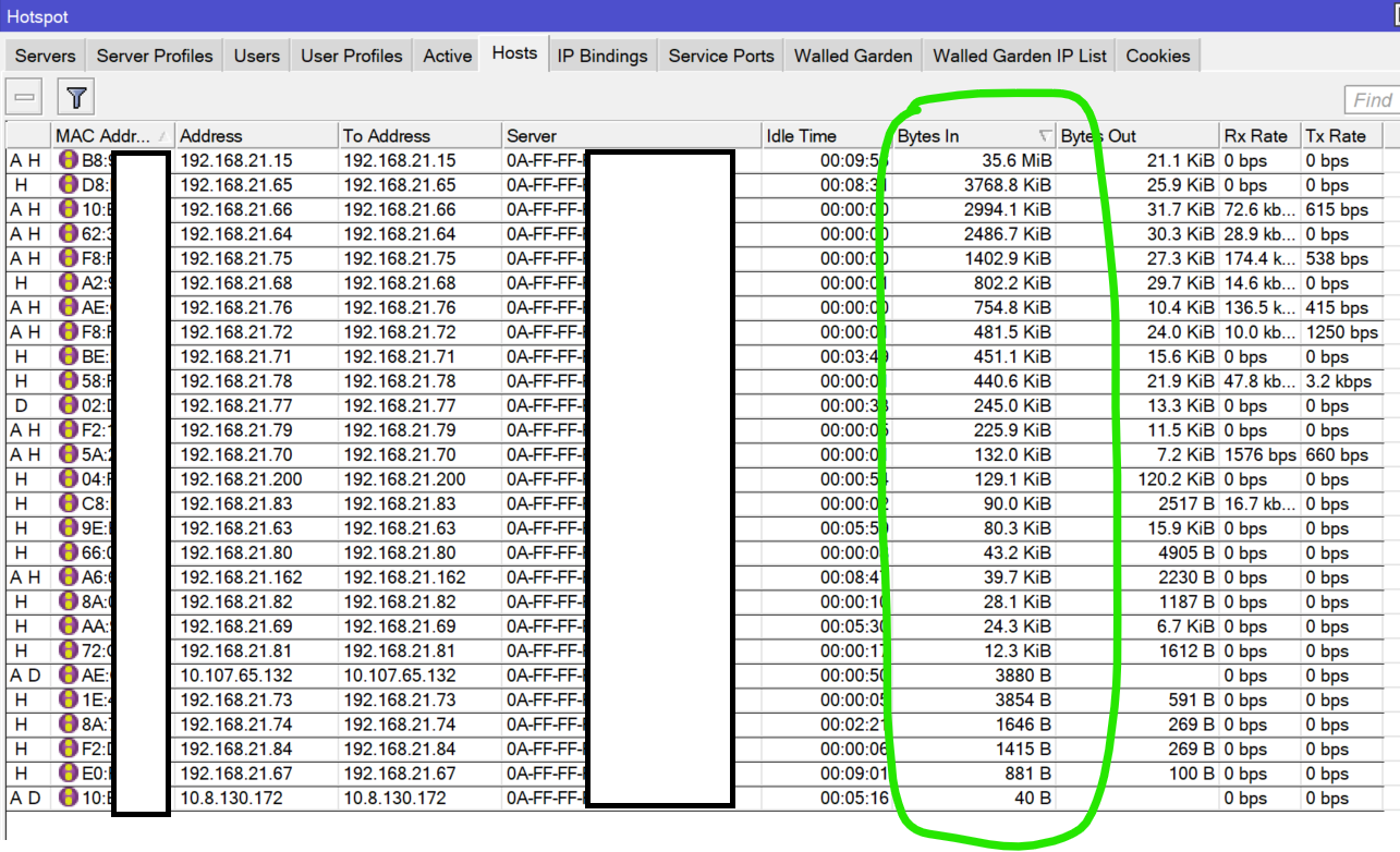

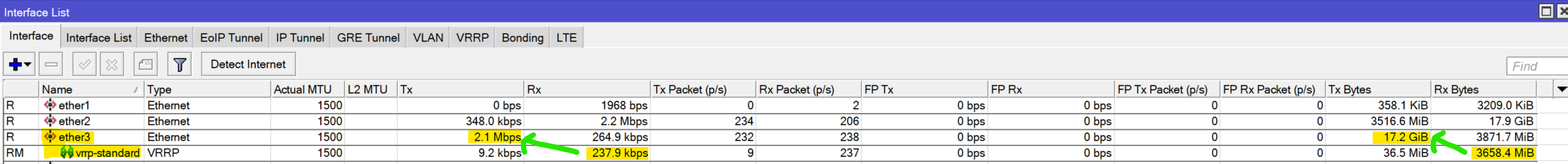

You can see in this screenshot the difference, the hotspot interface shows 3.6GB whereas ether3 shows 17.2GB etc
Hotspot hosts:

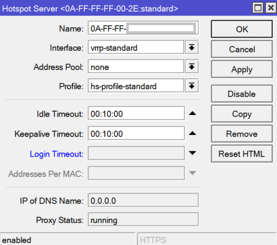

Hotspot server:

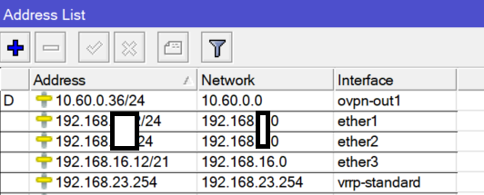

Addresses:

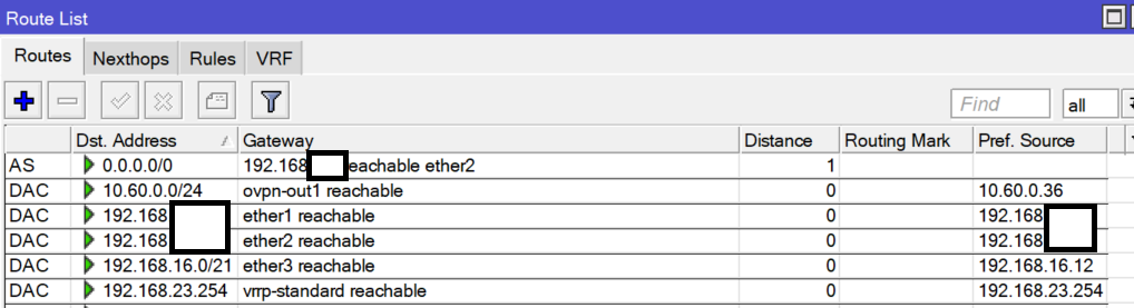

Routes:

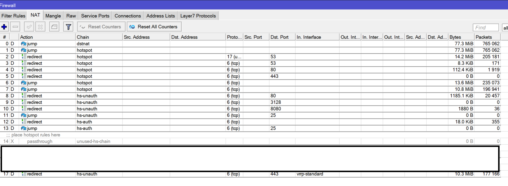

FW nat:

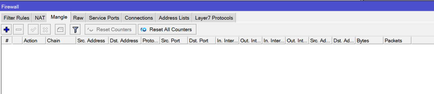

FW mangle:

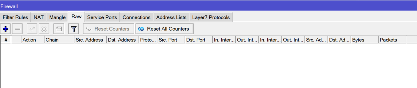

FW raw:

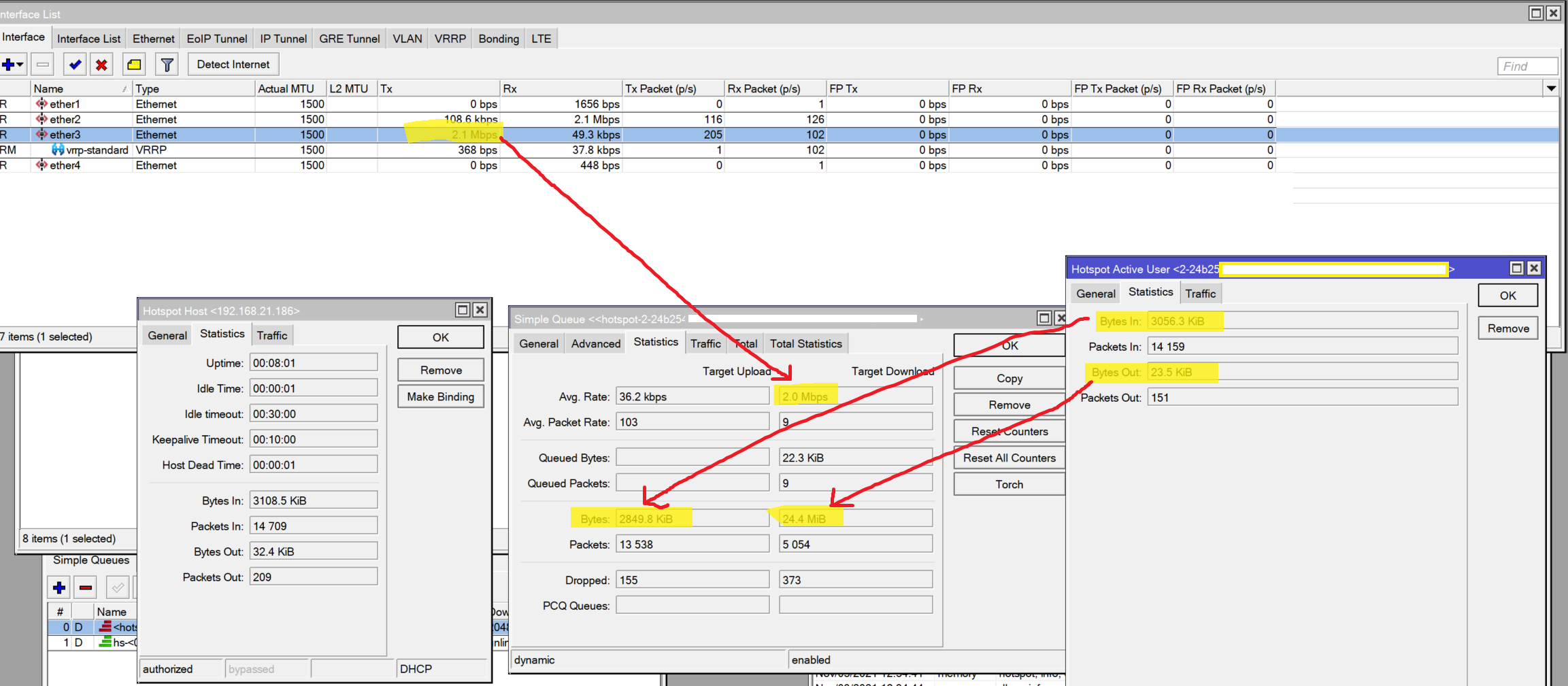

Some more info, I’ve realised in the “Queues” the traffic for the client traffic is showing correct, is the queue causing the problem?
We’re limiting the user/s bandwidth to 2Mbps down/up hence the queue…
Comparison of what the queue shows as opposed to the hotspot user:
