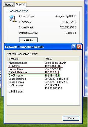

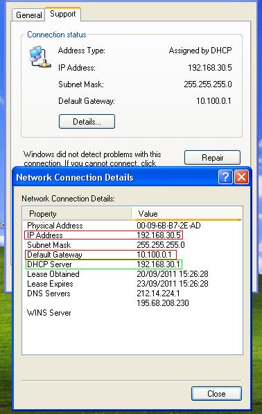

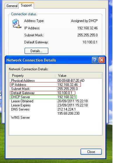

and you can see in the pic's - both dhcp servers work in same virtual gateway with tow Lan cards
so im using one gateway one domain:::::in tow LAN's tow dhcp servers tow ip's ranges
