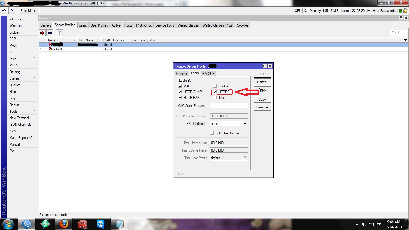

Did you check with this?
Hi satish
It was not ticked but Ihave done so. Problem persists. Page not available on https but available on http.
Any other ideas??
I don’t think using login-by=https is the way to do it. Besides, you would need a SSL certificate installed.
