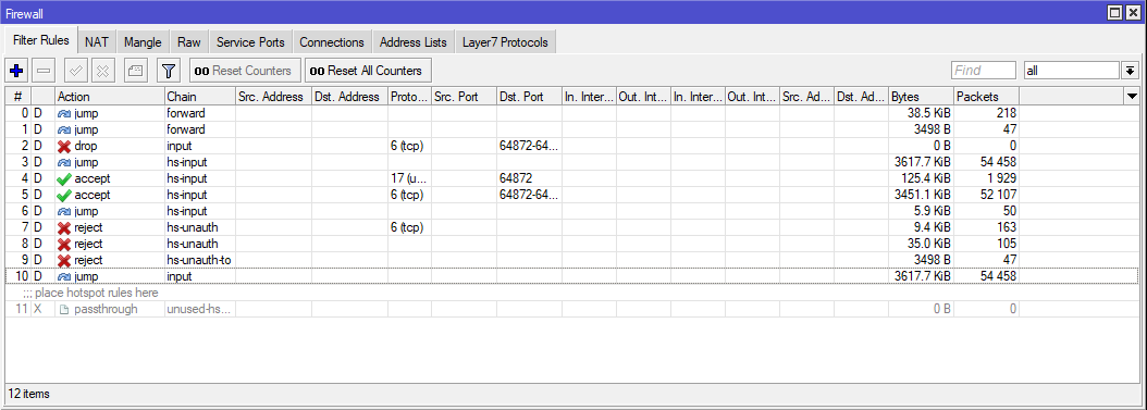

I don’t have rules like that under my firewall rules?
Post your FW rules here.
Here

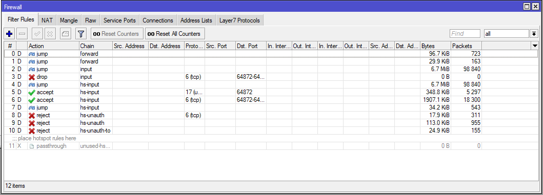

Drag rule 2 to be below the hotspot rules.
Like this?
Yes. Any changes?

I have a problem regarding this method, you see I have scripts in place to switch my hotspot on and off at certain times as my isp gives a night time data that I want open to everyone.
It seems like Rule 2 that I moved, moves back with the restart, any way around this?
So I was able to create a script and schedule it for when the hotspot starts up.
Seems like the counting of usage is working much more accurate after moving that rule.
