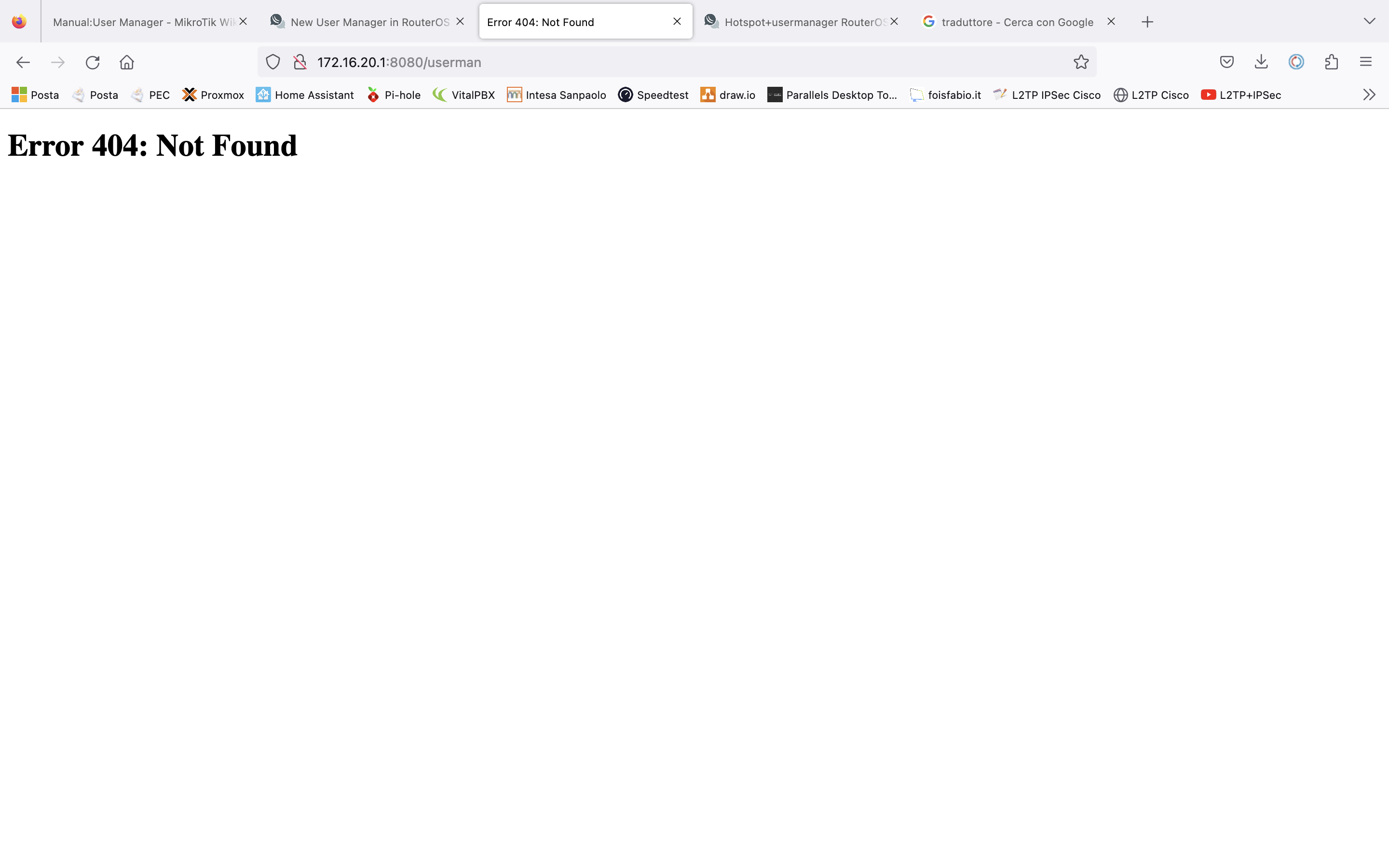

Hi, I would like to use hotspot with usermanager in routerOS v7.7. Hotspot already has the basic configuration, but how to interface it with user manager? also from LAN if I call the usermanager web I get error 404

Your last screenshot 172.16.20.1:8080/userman,what do you need to archieve in ROS7 with that address? That page address is for previous version of User-Manager, will not work with UserManager at ROSv7.
And until now ( v7.8 ) as far as I know, hotspot redirection page for customer still somehow broken. Customer will still get the hotspot login page when they first login to the AP. But as soon as they login, (again as far as I know, enlightment me if someone know how to fix), entering hotspot dns (your case is “http://green.hotspot” or even with ip) will make address not found error.

If ‘user manager web page’ you mean as previous ROS6 UserManager for managing userman AKA 'http(s);//hotspotdns/userman", in ROS7 it doesnt exist anymore. If you insist about that better you go back to ROS6.
At ROS7 UserManager, all managing will be done from Winbox via terminal or directly to UserManager Menu.
Please read more here https://help.mikrotik.com/docs/display/ROS/User+Manager

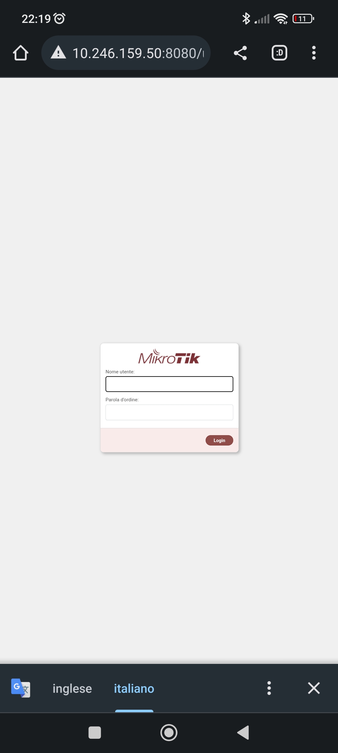

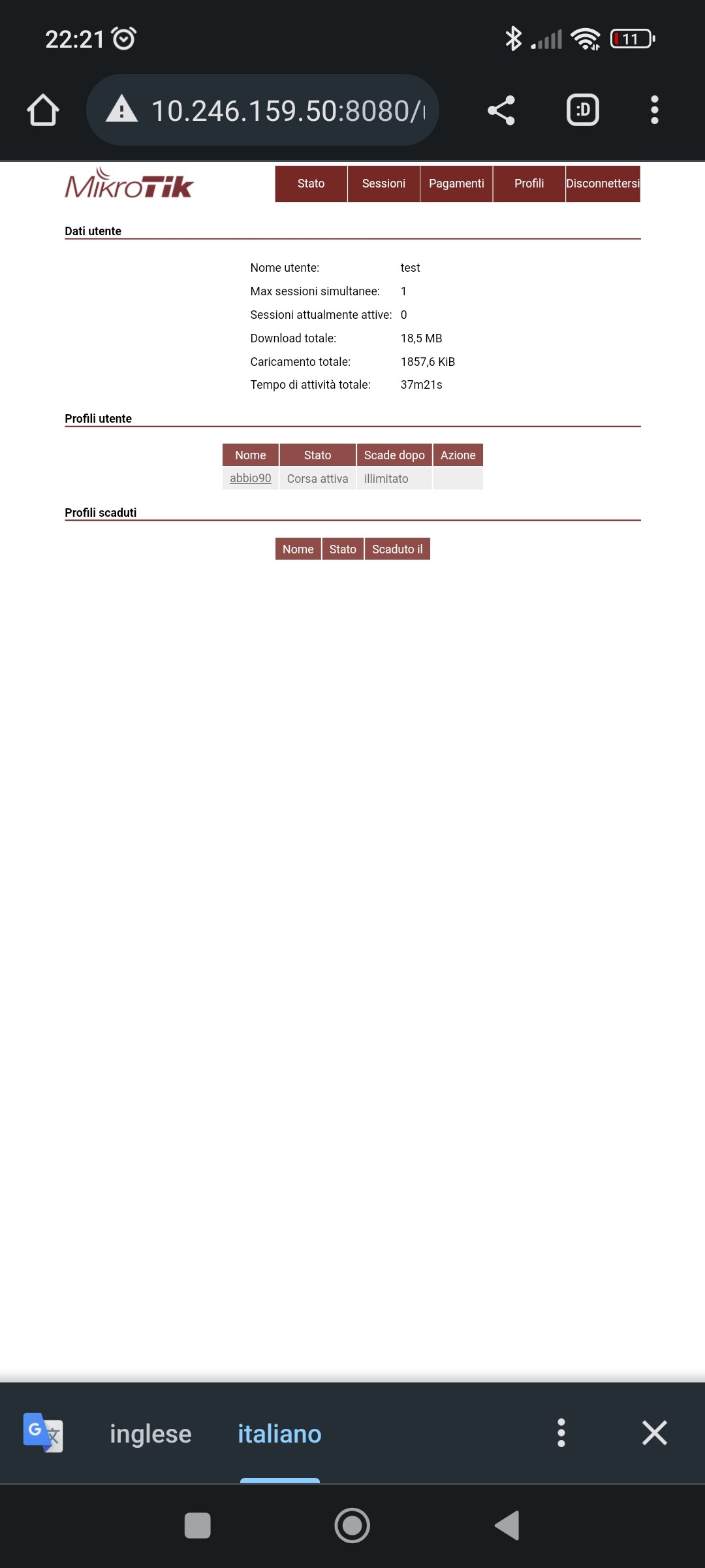

The only web page interface in ROS7 UserManager is http(s)://hotspotdns/um you can read about that at Web Interface section…
“Each user has access to his personal profile using a WEB interface. The WEB interface can be accessed by adding “/um/” directory to router’s IP or domain, for example, http://example.com/um/. Note that the WEB interface is affected by IP Services “www” and “www-ssl”. The WEB interface can be customized using CSS, JavaScript and HTML.”
For me this section still cant be done, due always error to try open hotspotdns via web browser, after login.
I confirm, the page is accessible. What if I want to manage PayPal payments after the ticket issued at the first login has expired?
