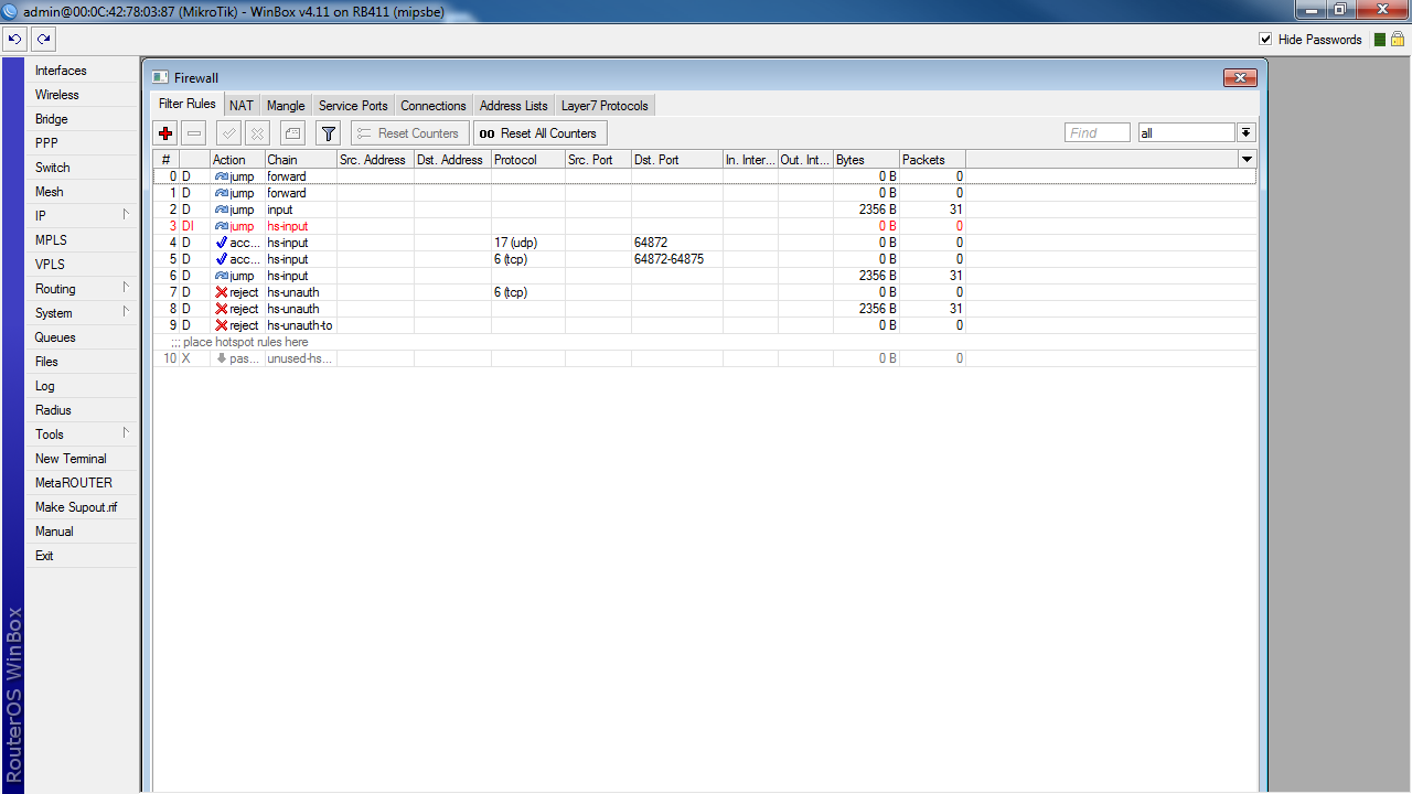

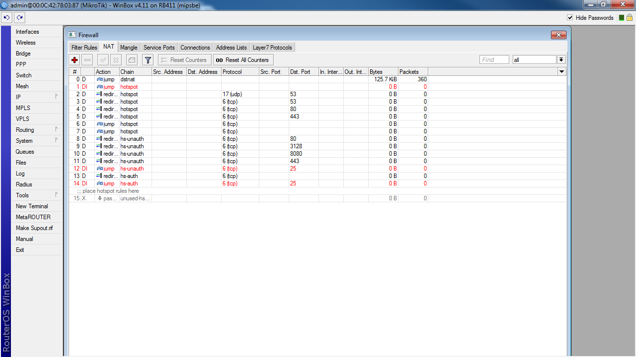

So I set everything up as I think I should have. For some reason my machine can connect to the AP and access the network and no auth or web page redirection occurs… It is as if even though I configured hotspot and enable everything it still does not work…
See attached…

There are a few things that could be wrong, but the hotspot profile is incorrect. The profile hsprof1 does not exist.
/ip hotspot
set 0 profile=default
Also, set the “/ip dns” settings or the hotspot will not redirect.
The hotspot is assigned to bridge1 with ether1 and wlan1 as interfaces on that bridge. Which interface on the router is the WAN interface? The entry in “/ip route” indicates it is ether1. That won’t work. The hotspot must be on LAN interfaces.
This is an RB/411 with one ethernet port. IT is an access point. Ether1 and wlan are bridged. ether1 is connected to the internal network.
The RB411 has a level 3 license. I’m not sure if that supports the hotspot service. (edit: Level 3 license states 1 user maximum for the hotspot, so it may.)
But despite that, ether1 is your WAN interface. You can’t have the hotspot on the WAN, and by bridging the two interfaces, that is what you are doing. The only interface that would be capable of running a hotspot on your RB411 would be wlan1. That is your only LAN interface. You would need to remove the bridge to do that.
If the hotspot is running on the 411, bridging eth1 and wlan1 will conflict with its hotspot configuration. The hotspot and internal network should be on separate subnets, and routed rather than bridged.
With a L3 license, it will be limited to one hotspot client. Other radios may try to associate, but they will never succeed–a frustrating prospect. Of course, the board could have been upgraded to a L4 license; you’d have to find out. Use “/ system license print”.
