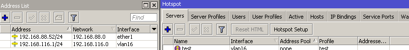

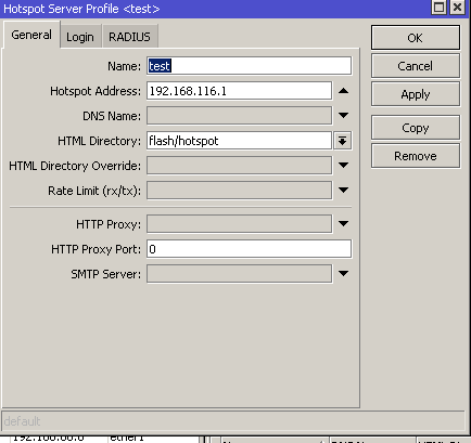

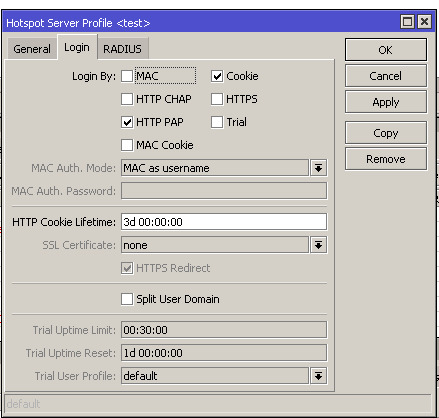

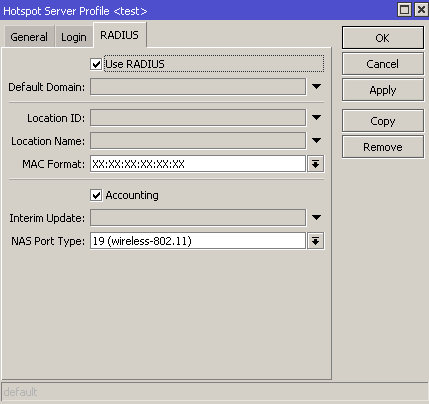

Good afternoon. Faced the following problem:
Mikrotik (cap ap) acts as an AP with activated hotspot: authentication by login, password, http-pap, and authorization on the radius server. The vlan of the guest network is thrown on Mikrotik. The DHCP server is behind mikrotik, which issues addresses to connected clients. When you connect to the guest network and go to the login page, you may get the error err connection refused. It is the same after entering the username / password. The walled-garden contains the allowed dns of the server, the radius of the server and the guest subnet. Has anyone encountered such a problem?
