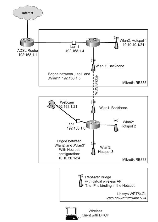

I have a running Hotspot with 2 problems:
  • It should be possible th configure the Webcam from the ADSL router Lan. At the moment I can configure both mikrotik router (IP 192.168.1.4 /1.5). I cn not open a connection to the webcam. what can I do?
-The hotspots in general works fine. But when a DHCP client (no fix ip adresses) connect over a Linksys repeater, the hotspot returns no IP. After a few secondes, the Client works with a random IP adresse. How can I setup th hotspot, that it returns direkt an IP from the DHCP Server?

I thing that “Transparently Bridge two Networks” will be useful for you. I have similar situation and it wokrs.
(http://wiki.mikrotik.com/wiki/Transparently_Bridge_two_Networks)

The Problem is then the bridge between Hotspot 2 and 3. We have the no connection from the bridge to the lokal network.
No other ideas? :confused:
The problem is fixed. Thanks for your help.
