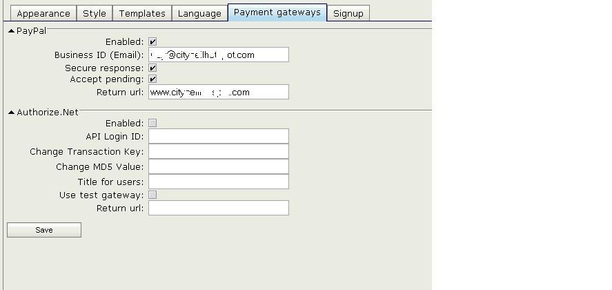

attached router paypal config.
but at paypal account what should i add and where pls.
Does your User Manager router have a SSL certificate? You have selected “Secure response”. That is https as I recall.
I’m not sure I would use the “pending” selection. It will do a callback if the payment processing was delayed for some reason.

my router have ssl certificate yes ,.
i tried to disable secure response same result

I’m not sure I can help a lot with PayPal. I use Authorize.net with a FreeRADIUS server. I have the advantage of being able to modify the php/MySQL code to meet my requirements.
I don’t know what PayPal calls it, but Authorize.net has a “sandbox” (test gateway?) feature. That allows you to test the setup without billing anyone’s account until all is working. Did you try that first?
edit: Insure your firewall rules in the User Manager router allow the PayPal server access for the callback.
I normally don’t double post, but I missed the edit on your last post. It is called a sandbox also. I did a search on the PayPal site, and this was one of the links:
https://www.x.com/developers/paypal/sandbox?bn_r=m
I think this is what you need. I’m sure the “Getting started” link there will explain all you need to know.
