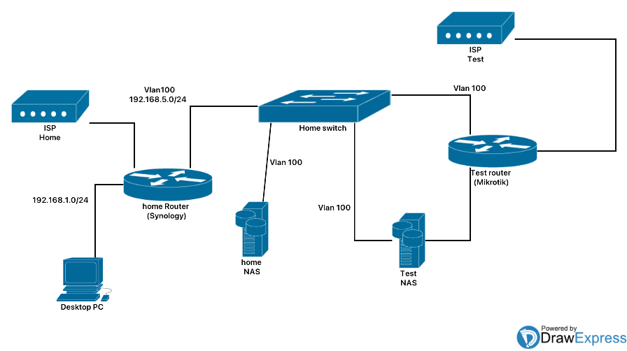

I have a small home office whit two routers, one is my Home Router (a Synology RT2600ac) where I have created a VLAN which connects to a small switch; the other is my Test Router (Mikrotik) and each router does have it’s own independent internet access, so far so good.
Because when I want to do some configuration to my Test Router, now I have to disconnect the ethernet cable from my Home Router and connect it to the Lab Router with is a pain. So I would like also to access locally from my desktop computer connected by ethernet to the Home Router, the Mikrotik Test Router as I can do whit all the devices I have already connected to this switch.
Pls let me know how I can achieve this at the Lab Router. Attached the diagram of my network and the configuration of my Mikrotik Lab Router.

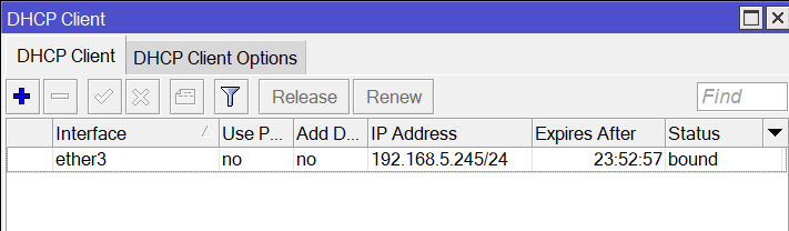

add add-default-route=no default-route-tables=main interface=ether3 \
    use-peer-dns=no use-peer-ntp=no

What these networks are? Are you sure that addresses are OK?
These are REALLY strange
I suggest to reset router to defaults, connect it to VLAN100 on a switch and try to connect to it from any other VLAN100 based place in your network. If port on a switch properly removes VLAN100 tag on egress then your 5009 should get IP on that network on ETH1.
You should after reset to connect to 5009 and enable DHCP client on it's WAN port and enable Winbox server and MAC server on WAN too. Suggest to enable Neighbehood discavery on all ports to see what you can see on the network from 5009's perspective and than try to find what is needed to see the 5009 from the network.
On the sent config I changed my real addresses whit this fake 000.000.000.X address.
The MK 5009 lab router is working so I just need to find out how I can set up a ethernet port on this router to be accessible by WinBox from the Home Router. At this moment if I want to make some config to the Lab Router I have to disconnect the ethernet cable that connects the Home Router to my desktop computer and connect from the desktop computer to the Lab Router which is a pain to do so each time back and forth.
So that is why I suggest turning on Neigherhood discovery + torch on the WAN inerface to watch what kind of packets are visible. Tagged, untagged, what IPs ... any information that could help configure 5009 to talk via switch to or maybe the switch is misconfigured and that is why you can't reach 5009.
Did you enable access to 5009 with it's interface faced to switch? Firewall? Winbox server? Webfig?

Hello everybody,
Well I found solution myself and now I’m able to connect to my TEST Router from my Desktop PC (connected to the Home Router - see network topology above)
I just have to add to the TEST Router configuration included above this:
add disabled=no dst-address=192.168.1.0/24 gateway=192.168.5.1 routing-table=
main suppress-hw-offload=no
Now I can access using WinBox on my Desktop PC the TEST Router.
Anyway any comment will be gladly received.
