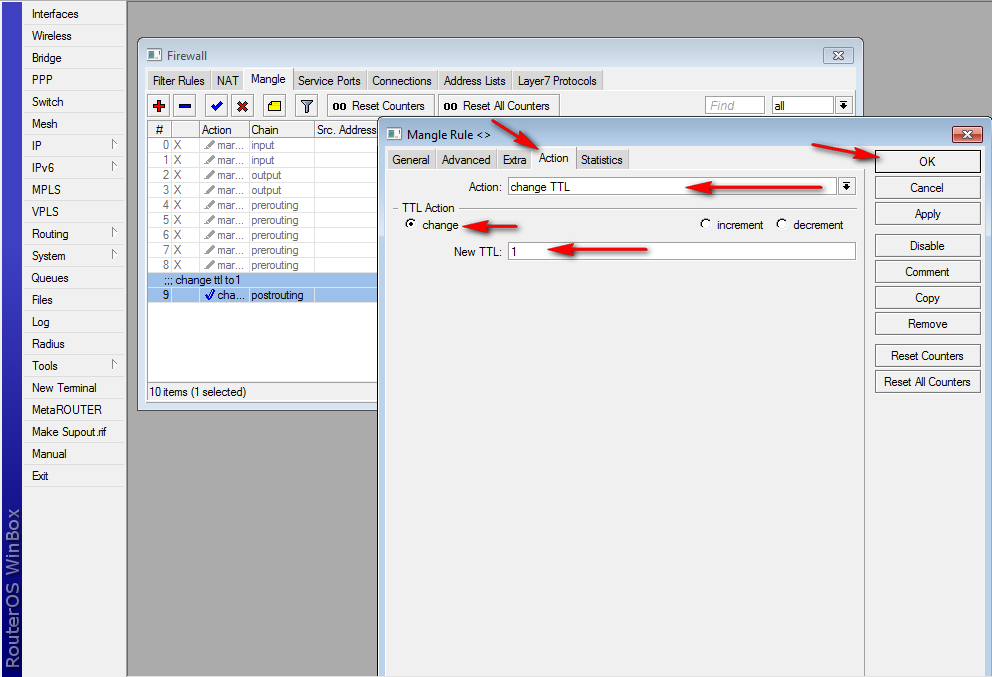

In version 5.0 and down, you can change the TTL equal 1
all sharing internet can stopped , but in version 6.0 and up , the programs can’t stop ,
note: if you create PPPOE server and work true on one session … all programs can drop ! only on PPPOE server !!! why if not create pppoe server so that programs not cant drop .
you can see below how can change the TTL equal 1
Changing the TTL is still an option in my router, which is running the bleeding-edge 6.34.1
You could do a sniffer capture on the LAN interface to confirm that the outbound TTL values are indeed being set to 1.
If they are being set to 1, then the client’s sharing devices are incrementing the TTL again, or ignoring the TTL.
If you can set it to 1, then they can set it back up to 255 if they want.

Try to limit connections or packets. For sure you can see a difference between a normal client and those who sharing. This will not stop them to share but for sure will make them problems :slight_smile: . Some years ago I was changing the TTL to 1 and luckily they did not know to increment it again .
