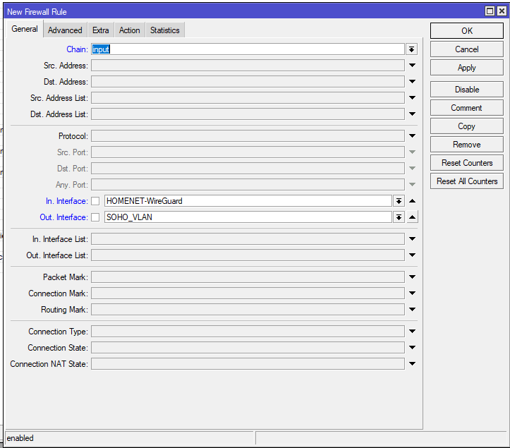

I tried adding the following but got an error: “Couldn’t add New Firewall Rule - outgoing interface matching not possible in input and prerouting chains (6)
My local lan is 192.168.16.0/24 (SOHO_VLAN) VLAN_ID=10
The WireGuard remote devices are assigned 192.168.66.0/24 IP addresses.
Today from a remote device I can ping a device on my local LAN, but pinging the 192.168.66.x IP address of the remote device does not work.

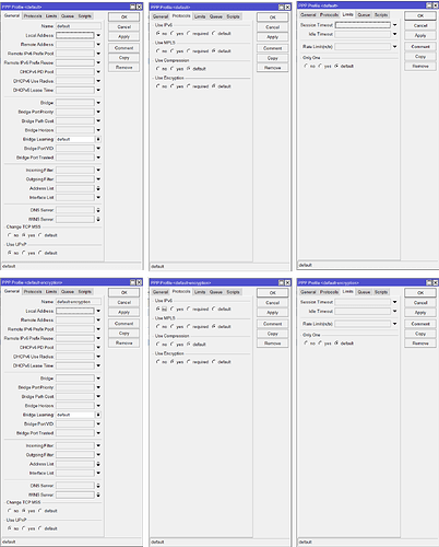

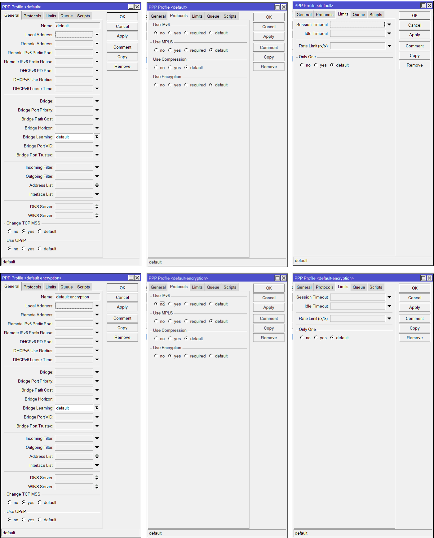

  1. Something I didnt mention the first go around, as I dont use PPP, but you seem to have some errors there.........
    /ppp profile
    set *0 use-upnp=no
    set *FFFFFFFE use-upnp=no
What are you attempting to do here, as those do not look like default settings???

  2. You still havent explained why we are seeing the *0 and *FFFFFFFFFE in the ppp profile. On my routers this doesnt even come up as a default setting???

  3. I cannot explain these values. Below are screen settings of the ppp section through Winbox.
