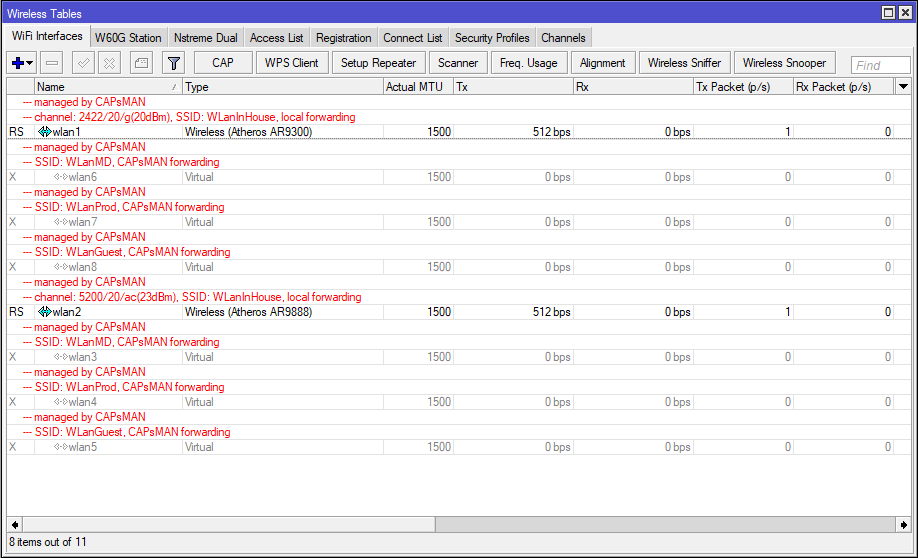

I came across a (probably rare) issue where the cap showed me that the Wlan is working just fine (Picture 1). However, I faced some issues where the signal was very poor so I checked my Wi-Fi coverage and found out that this particular AP does not provide 2.4GHz Wlan.

Looks like you have it set on channel 3, and only g, what did you set it to on the capsman ?

I didn’t choose a channel manually.
Unfortunately my Wireless Devices (scanner for the warehouse) only support the g band. I Already had the g/n band enabled, but it only causes problems e.g. cant connect at all or there were even issues while roaming between the AP.
