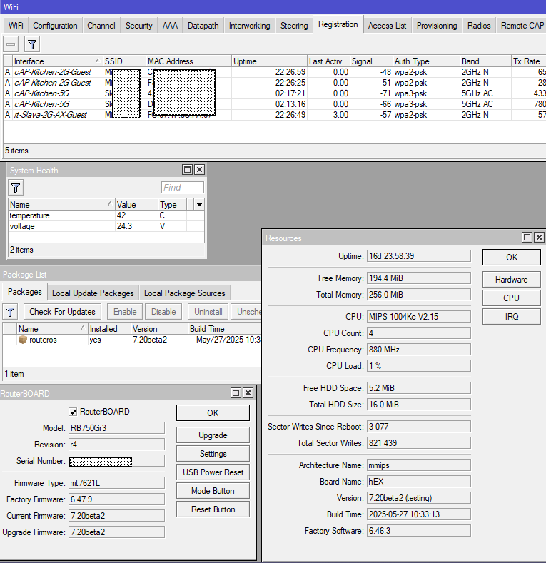

You can perfectly use Hex as controller for wave2 devices as long as it runs a ROS7 version >=7.13

I have the hEX doing great as a CAPsMAN controller. And there is plenty of free space.
