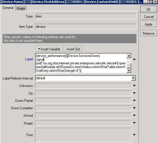

how can get the signal strenght from a wireless mikrotik device?. For exemple, for puting it in the device appearance at label like a Device variable. It’s possible? Any idea?

Yes, this is possible chikito.
I achieve this using OID, you have to select it in the item.
This is an example of what it looks like in one of my devices.
[Device.Name]
[device_performance()]Signal: [oid(“iso.org.dod.internet.private.enterprises.mikrotik.mikrotikExperimentalModule.mtXRouterOs.mtxrWireless.mtxrWlStatTable.mtxrWlStatEntry.mtxrWlStatStrength.5”)]
Result is something like:
Radio
cpu: 10% disk: 40%
Signal: -68
There are probably some other ways, but thats how i’ve achieved it.

many thanks ricrc,
but i still without seeing the signal strenght (or whatever oid) in appearance label. This line is copy and paste from my dude:
[oid(“iso.org.dod.internet.private.enterprises.mikrotik.mikrotikExperimentalModule.mtXRouterOs.mtxrWireless.mtxrWlRtabTable.mtxrWlRtabEntry.mtxrWlRtabStrength”)]
I have tried with anothers too:
[oid(“iso.org.dod.internet.private.enterprises.mikrotik.mikrotikExperimentalModule.mtXRouterOs.mtxrWireless.mtxrWlStatTable.mtxrWlStatEntry.mtxrWlStatStrength”)]
[oid(“iso.org.dod.internet.private.enterprises.mikrotik.mikrotikExperimentalModule.mtXRouterOs.mtxrWireless.mtxrWlStatTable.mtxrWlStatEntry.mtxrWlStatStrength.4”)]
I’m using 3.0Beta6 dude version and I’ve check that in my mikrotik device there’s something connected because there’s some information in wireless>registration-table
Anyone knows if I’ve have to do something more for seeing oid? Any idea?
How is this wireless link configured? I have found this only works on ap/station mode or bridge+wds/station wds.
It does not work with bridge+wds/bridge+wds
