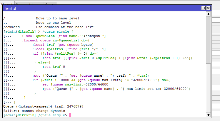

So try this:
/queue simple {
    :local queueList [find name~"^<hotspot-"]
    :foreach queue in=$queueList do={
        :local traf [get $queue bytes]
        :local splitPos [:find $traf "/" -1]
        :if ([:len $splitPos] != 0) do={
            :set traf ([:pick $traf 0 $splitPos] + [:pick $traf ($splitPos + 1) 255])
        } else={
            :set traf 0
        :put ("Queue (" . [get $queue name] . ") traf: " . $traf)
        :if ($traf > 10000 && [get $queue max-limit] != "32000/64000") do={
            set $queue max-limit=32000/64000
            :put ("Queue (" . [get $queue name] . ") max-limit set to: 32000/64000")
EDIT:
Wait “failure: cannot change dynamic”, so we can’t change the “max-limit” property of a dynamic queue?
Ok that I have no clue about then, try looking in the hotspot manual for that.
yes this is the problem dynamic cannot be changed and i’v been looking for other way but i couldn’t
is there a way ?? this maybe help http://forum.mikrotik.com/t/dynamic-items-unchangeable-why/91225/1 should i downgrade?
i downgrade to 6.30.4 and this what i get now> maybe we could change user profile to another and reduce his speed can u change that in script
As said in that thread, you have to control the Hotspot Users rather than the queues.
The queues are dynamically created and changed when the user is changed.
I just don’t know anything about the Hotspot feature, so I don’t know what values need to be changed.
But looking a little bit at it, it looks like you can set a “User” to use a “User Profile” and the user profile can have a rate-limit. So it should be easy to loop through the users and change their user profile to a user profile that has a rate-limit.
