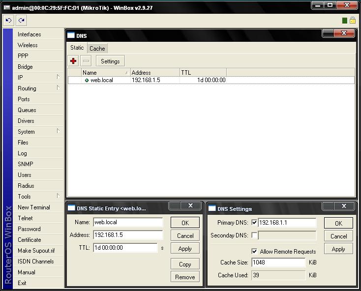

the purpose :
I have a local website in the same clients network has an ip 192.168.1.5
i wanna reserve the “web.local” domain for this ip 192.168.1.5
when i use the dhcp server it gives the clients the ISP dns settings for example 84.36.0.75
this dns does not help me of corse with my purpose .
and it will be good for caching dns for the external websites , is it true ? how?!! :confused:
Configure DNS Proxy,
primary dns= Original DNS1
secondary-dns=Original DNS2
allow-remote-request=yes
Now you can use your gateway as a DNS address.
I think you can configure in this way as bellow but for TTL I am not sure for the value.

But if you really want to use it 84.36.0.75 goes in the primary DNS field of the screenshot.

Along with setting your DNS in your MT box as noted above with your public DNS IPs - I suspect you are using the newer MT ROS so set the UDP packet size to 1024 vice the ‘standard’ 512 bytes. Also watch your cache size for DNS - if you run out of cache it can cause issues (I didn’t say ‘it will’ here folks - I said ‘can’). Also if you see you cache regularly full then increase the size of the cache a few K (1024) at a time.
Once you do the above - then set your local clients DNS to your MT box IP address as their DNS server.
