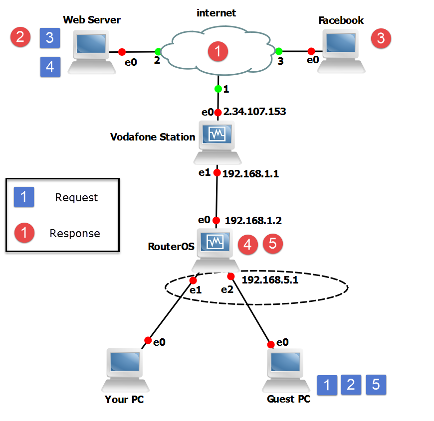

OK, one last attempt… Check the following image:
Each network request is denoted with a number. The device making the request is with a blue square, and the device that responds to this request is with a red circle.
I’m telling you RouterOS login can only happen between the two devices on step 5. It can’t happen between any other two devices.
