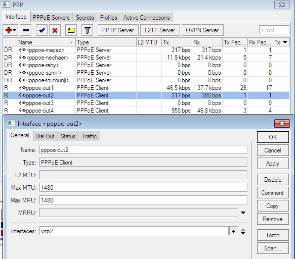

one line for upload, the other 7 adsl line for download with no upload…why?

Load balancing based on PCC uses one line per connection. The more connections, the more balanced they will be. Straight HTTP downloads are one TCP connections.
In short, unless you control the routers at both ends and are lucky to have reliably low latency it is impossible to bond several lines and have one connections spread over multiple lines.
In my opinion they use MLPPP having asymmetric xdsl. on on side they do just upload/and managing traffic and on the other 7 ADSL they receive the download. Nice way to optimize adsl usage!!!
but it’s not a romalpa case.They claim that there is several channle to achieve.I kown balance with random nth pcc,but now,our discussion is one line tx, the others rx!
another case,look at the pppoe-out~ one upload,the other download…headache!nobody can explain this?~
they just src-nat connections with different addresses, which are on those pppoe interfaces
if ISP on ‘TEL’ interface isn’t blocking packets with other ISPs’ addresses - it will work

i notcie that your provider use pppoe and i blive that u use VLAN to make many connect with to many user

and wht about mac address for account (pppoe-out) can i have picture
