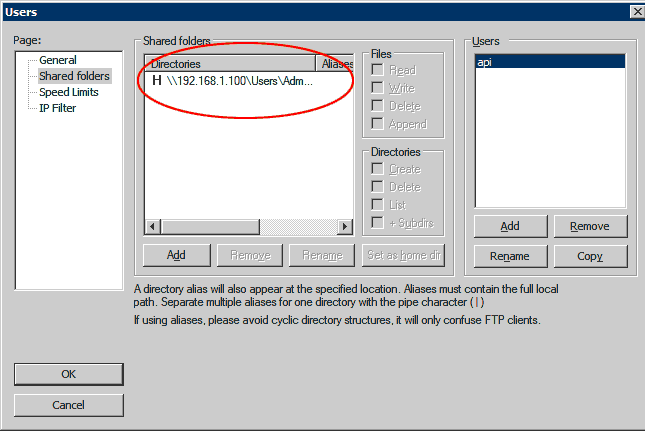

  3. Install Filezilla Server
  4. Set up a FTP account in Filezilla and point it to \192.168.1.100\Users\Admin\Dysk Google

Please check the attached picture which shows how to set up shared folders. Feel free to experiment around with Filezilla, for example try to set up any folder on your PC to work with Filezilla. Once you figure it out, you can check if it will work with Google Drive/Dropbox. Please remember, this is a Mikrotik forum and not a Filezilla forum.
