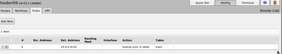

I don’t get it. I’ve told you that the purpose of the /ip route rule is to protect packets for LAN devices (in subnet 10.0.0.0/24) from being handled by routing-marked routes, and you have instead set it to handle packets towards 192.168.8.0/24 (which mostly do not exist).
If you modify that /ip route rule to deal with dst-address=10.0.0.0/24 and enable the two routes with routing-marks again, does it work or not?
As for NATing the traffic sent out via the two gateways as @alli recommends, don’t worry, the relevant /ip firewall nat rules are already there.
no does not work.
So two possibilities, either I have missed something else related to your unusual network setup, or there is some issue like in this topics.
So let’s start by disabling the special mangle rule for src-address=10.0.0.103, setting both the PCC rules to assign new-connection-mark=WAN1_conn and permitting the routes with routing-marks. After testing whether it works or not, set both PCC rules to assign new-connection-mark=WAN2_conn and try again. Report both results.
I tried again to insert 10.0.0.0/24 and the LAN seems to work

The /ip route rule must stay in place all the time - assuming you try from a device on LAN.

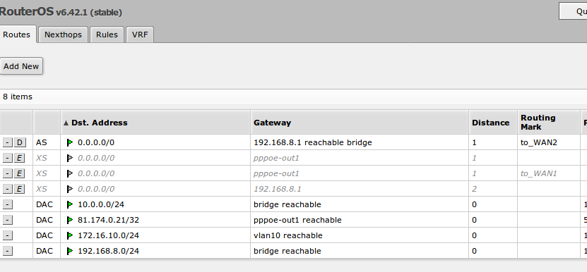

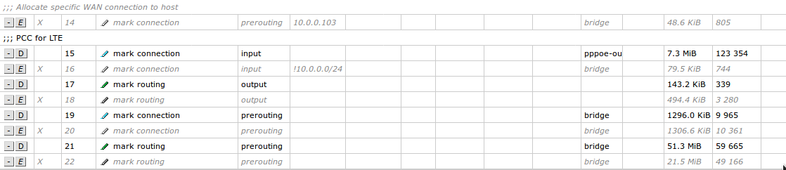

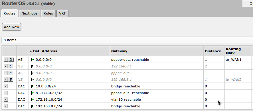

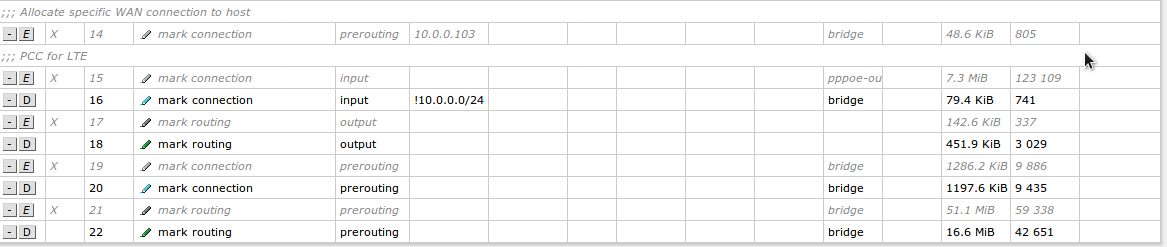

I activated the marked conections one at a time:
forWAN2:
does not work in both cases

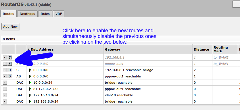

the two methods with wan1-conn and wan2-conn do not work
The blue text on the picture… did you always disable the two default routes (dst-address=0.0.0.0/0) without routing-mark when enabling those with routing-mark?
Because until now I was expecting the routing-marks to be assigned where they should not have been; if you have always disabled the default routes in table “main”, it could be that the routing marks were not assigned when they should have been.
