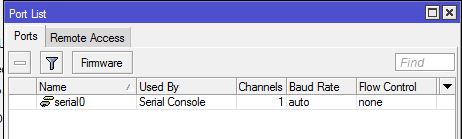

I have a RB 433UAH and modem Huawei E173 of H3G
In the System port i have only serial port 0
How i can configure the modem and use it on my lan ?

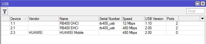

Tank you for your information, but my problem is on modem HUAWEI E173s-2
In the system resource USB i see the modem, in the system port, no

Modem is switched to wrong mode, that’s why it is not recognized by RouterOS.
Plug your 3G modem to Windows or other OS and run AT command to switch it to
correct mode,
AT^U2DIAG=1
http://3g-modem.wetpaint.com/page/Huawei+AT-commands
After command will be applied, modem will be recognized in RouterOS v5.12
