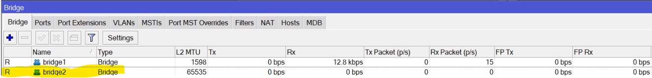

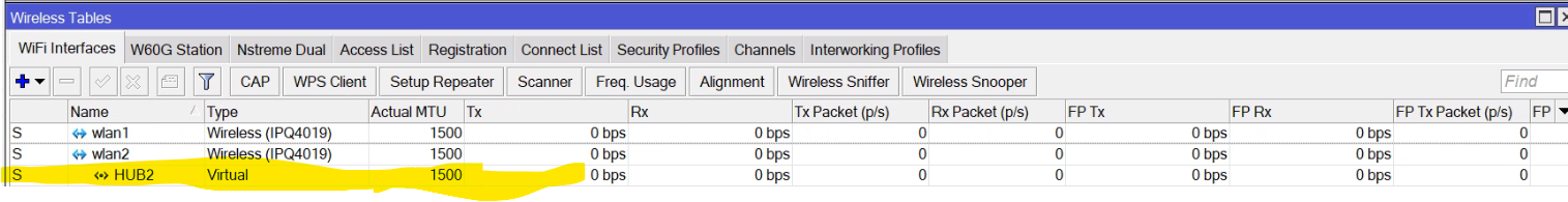

I created virtual wireless from wlan 2
I created a new bridge

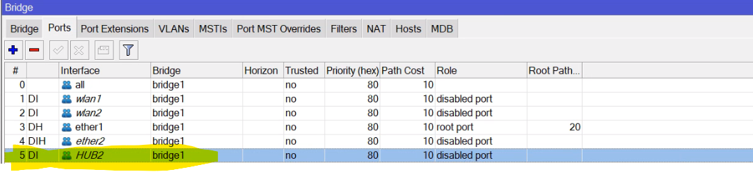

I noticed that my vitual interface belongs to the existing bridge. I can’t affect my interface virtual to the new bridge
I just did almost exactly what you described, except I already had the second bridge configured with IP addressing and DHCP server etc etc. Call them “bridge1” and “bridge2”, and the subnets x.x.1.0 and x.x.2.0.
I also already have virtual WLAN interfaces with a different SSID on both 2.4 and 5GHz wireless.
In Bridge / Ports I brought up each of the two virtual WLAN entries, changed the bridge from “bridge1” to “bridge2” and saved. I then connected my device to the second SSID and confirmed it got a DHCP lease from the second IP range assigned to bridge2.
