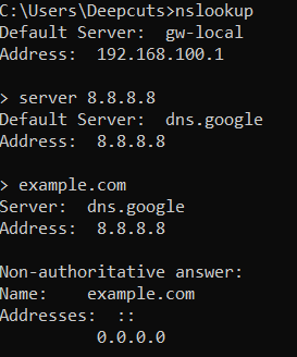

You can even do:
The client will try to connect to another DNS server and will think it is actually connected to it, as you can see from the above screenshot.
I have blacklisted example.com just for testing on pi-hole. As you see, it resolves to 0.0.0.0 “via” google DNS.
