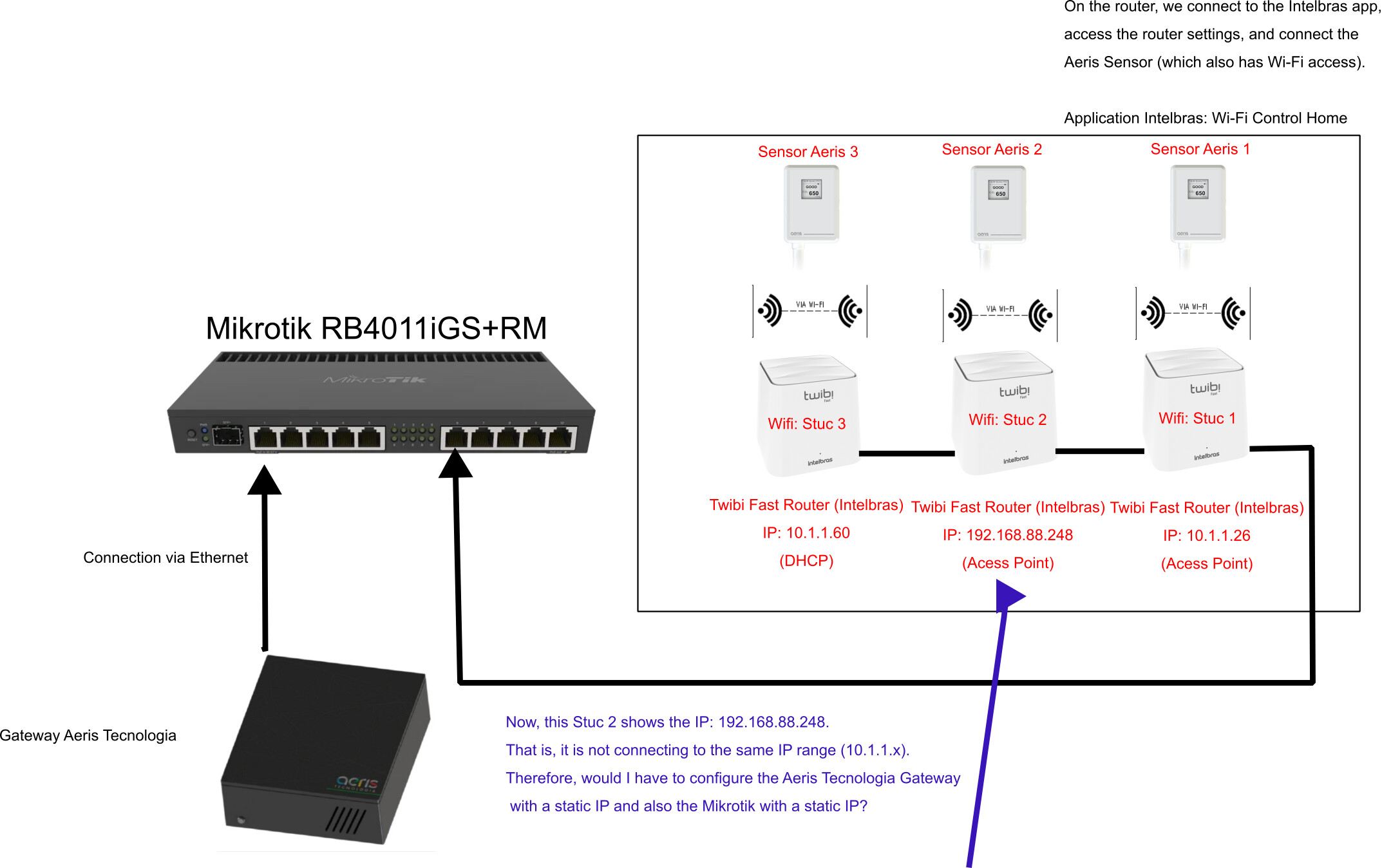

I'll send a network architecture. In summary: we have 3 routers installed in a panel, each panel has an Aeris sensor. This sensor connects to the Intelbras application (router installed in the panels - Twibi 3). Each router has an IP range, with 2 routers in access point mode, and the third in DHCP. So, we have: Router 3 (DHCP): 10.1.1.60; Router 2 (Access Point): 10.1.1.80; and Router 1: 10.1.1.26. And in the network architecture, there is a Gateway (Aeris concentrator) that connects to the Mikrotik via Ethernet.

I made a drawing to see if you can understand:
Now, this Stuc 2 shows the IP: 192.168.88.248.
That is, it is not connecting to the same IP range (10.1.1.x).
Therefore, would I have to configure the Aeris Tecnologia Gateway as a static IP and also the Mikrotik as a static IP?
I believe that might be the case. In that case, the recommendation would be to configure both the gateway and the Mikrotik router to use a static IP address?

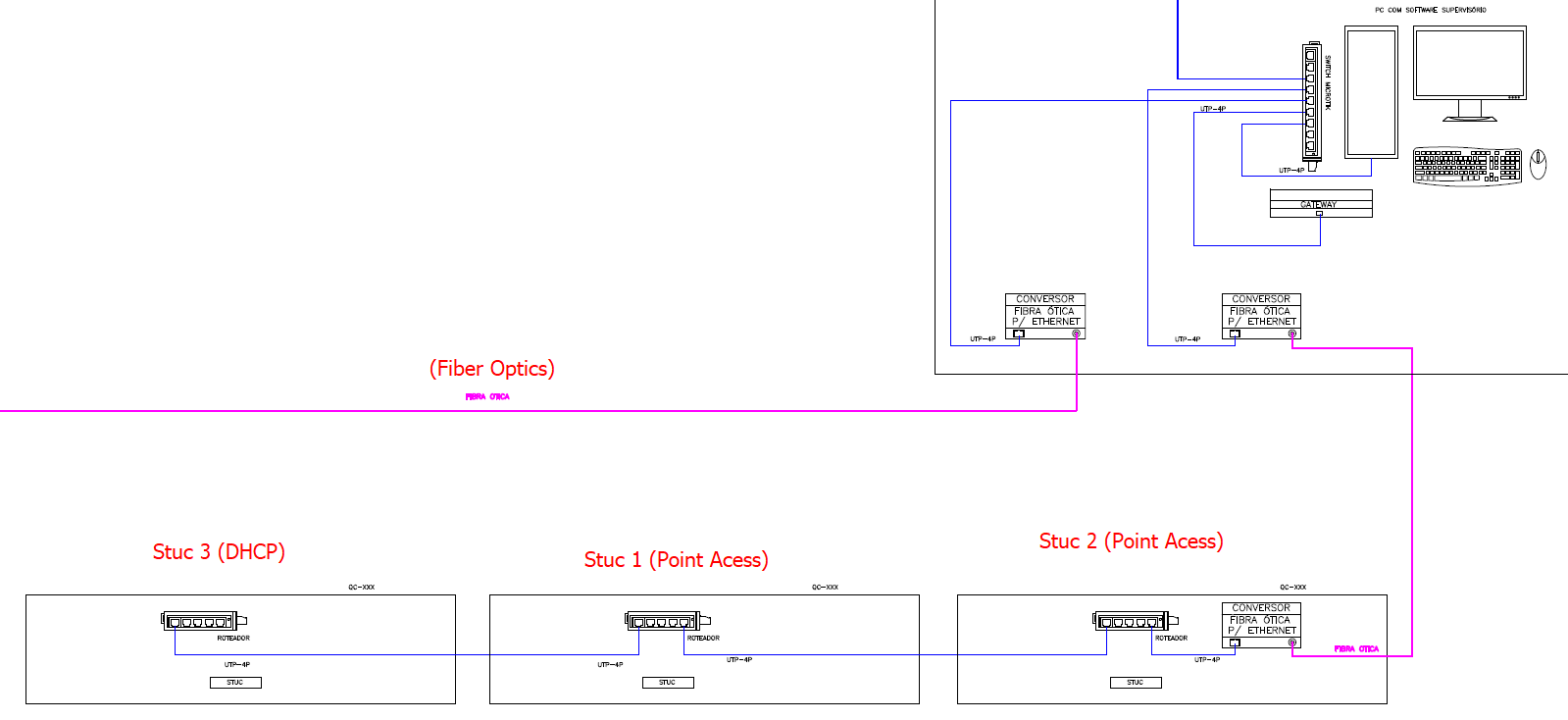

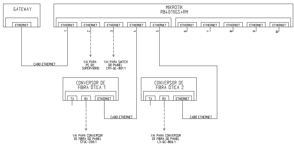

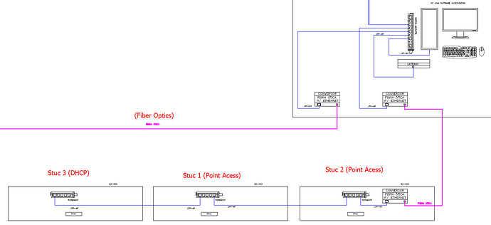

I had forgotten about the media converters (fiber optic to Ethernet) and the network architecture diagram to send you. My apologies.
With the image I sent now, can you understand the system?
Good afternoon. Please forgive me if I haven't phrased the question correctly, as it's a project I haven't done and I'm also trying to understand it in order to solve the problem. I'll be learning along with you all as well.
I'm sending the network architecture based on what I sent above. In the Stuc 2 diagram, they use a Fiber Optic to Ethernet Converter that sends to the Mikrotik.
If you have any further questions, feel free to ask. This "Gateway" is the Aeris Concentrator.
