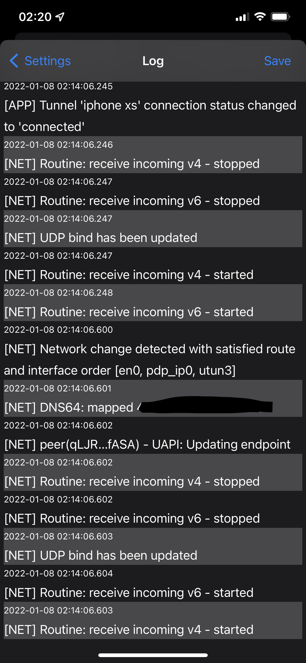

Update: Found this on the log:
denied winbox/dude connect from 192.168.40.2.
Was trying to test the connection by using winbox over cellular.

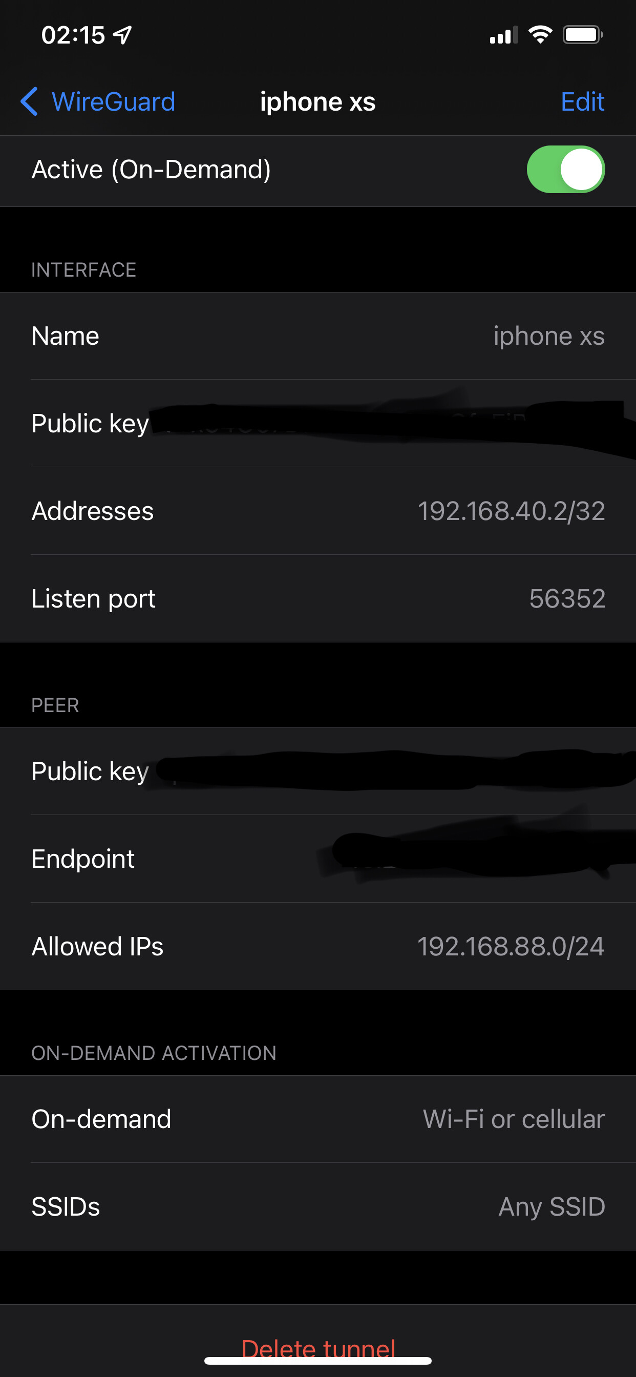

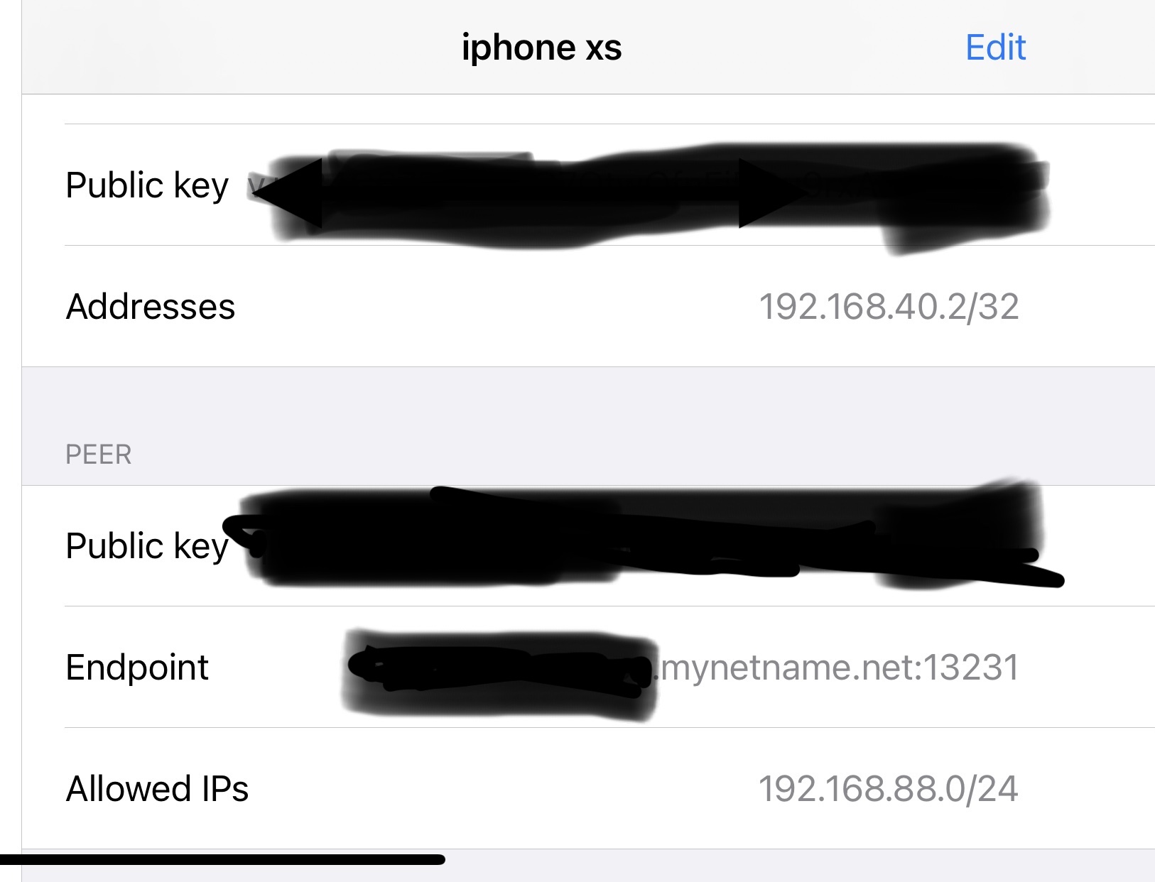

(3) The listening port on the iphone doenst seem to match up to the listening port on the MT Router server wireguard interface?? NM my bad, that would delineated on the end of the endpoint address like so xx.xx.xx.xx:13231
That’s weird. With client connected, I see current-endpoint-address=<client’s address> current-endpoint-port=<client’s port> rx= tx= last-handshake=<last communication, or whatever it is exactly>. Yours looks like there’s no connection at all. But then you could hardly have anything from 192.168.40.2 trying to connect to winbox port.

192.68.40.0/24
-didn’t get this part :frowning:
There’s no rx/tx for firewall rule, but counters for packets and bytes. It won’t be much, because most of established connection is accepted by another rule. But it should be more than zero.
Stupid question, you do have public address, right? You know what it is, and you’re aware that some address are non-public, so it’s not possible to connect to them from internet, and that it’s pretty common to have one. And you definitely have the right public one, correct?
My IP is dynamic, not static. I put a ddns address on wireguard client :frowning:
Static or dynamic doesn’t matter. Public or private does. In IP->Cloud, is the Public Address the same as you see in IP->Addresses? Or if not, are you supposed do have NAT 1:1? Or did you previously use something else that requires incoming connections and did it work?
