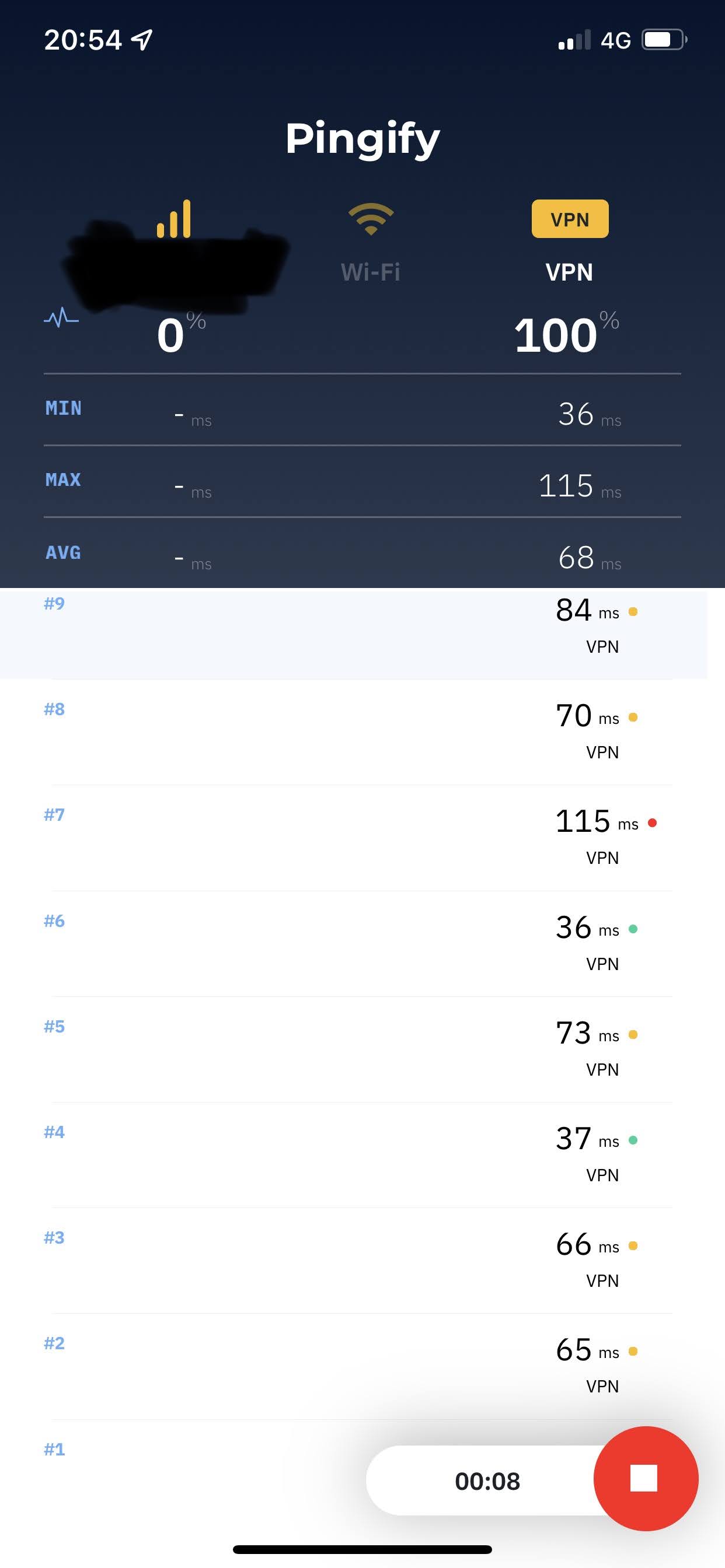

My wg client is 192.168.40.2, router 192.168.88.1. 192.168.88.108 is another device on the 192.168.88.0/32 subnet. 192.168.188.21 is another device in another subnet.
Ping from
192.168.40.2>192.168.88.1 ok
192.168.40.2>192.168.88.108 ok
192.168.40.2>192.168.188.21 failed
192.168.88.245<192.168.40.2 failed. (full packet loss)

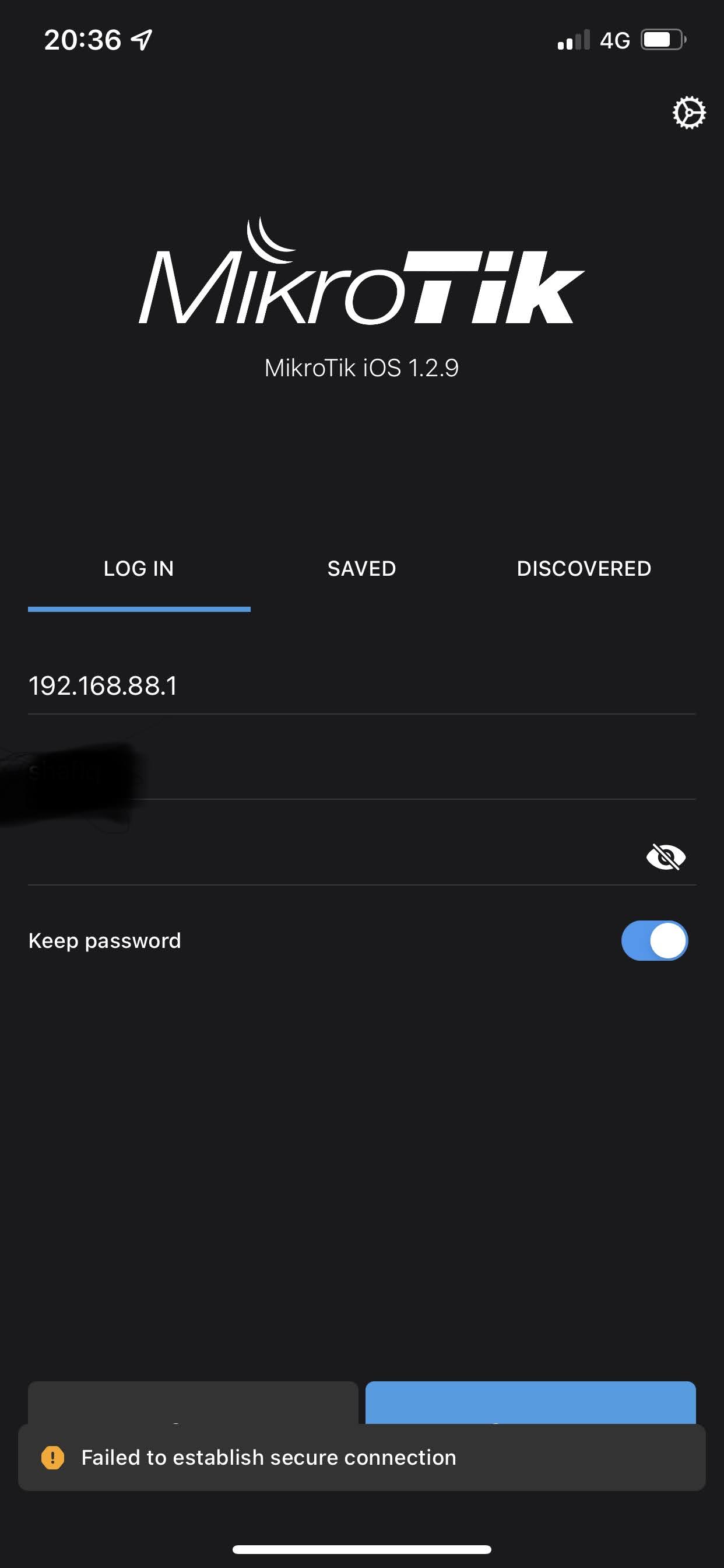

Also, I can access my router by browser but not with mikrotik app.

Step1 is Open the Wireguard Tunnel.
Then go to the MT APP.
You have to put in 192.168.88.1**:PORT#** on your APP

That’s expected and correct.
If you still have allowed IPs only with 192.168.88.0/24 on client, then 192.168.188.21 can’t pass through tunnel, because it’s in different subnet. And same goes for Reddit too. I understand that you rather believe your eyes than me, but it’s simply not possible. :slight_smile: Only way how it could pass through tunnel with allowed IPs 192.168.88.0/24 would be if you’d be accessing it using proxy server running on some 192.168.88.x. Or, just to cover all possibilities, you host Reddit servers in your LAN. Edit: or one more, it would be possible if it’s some dns-based blocking and you configure client to use router as dns server.
It should work, but it could be just client not answering pings. Not all devices do.

The other question is reaching the router for configuration purpose. I noted you needed both the IP address and PORT at the MT APP after connecting to the wireguard interface first. The other part of that equation is ensuring on the WG server that you have allowed the WG interface access to the router in the input chain.

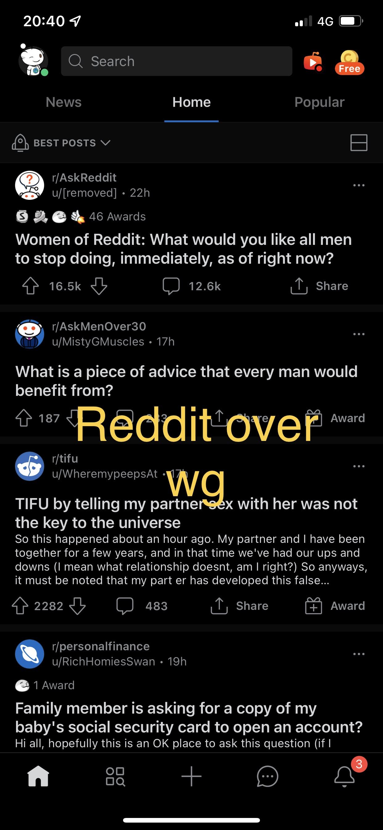

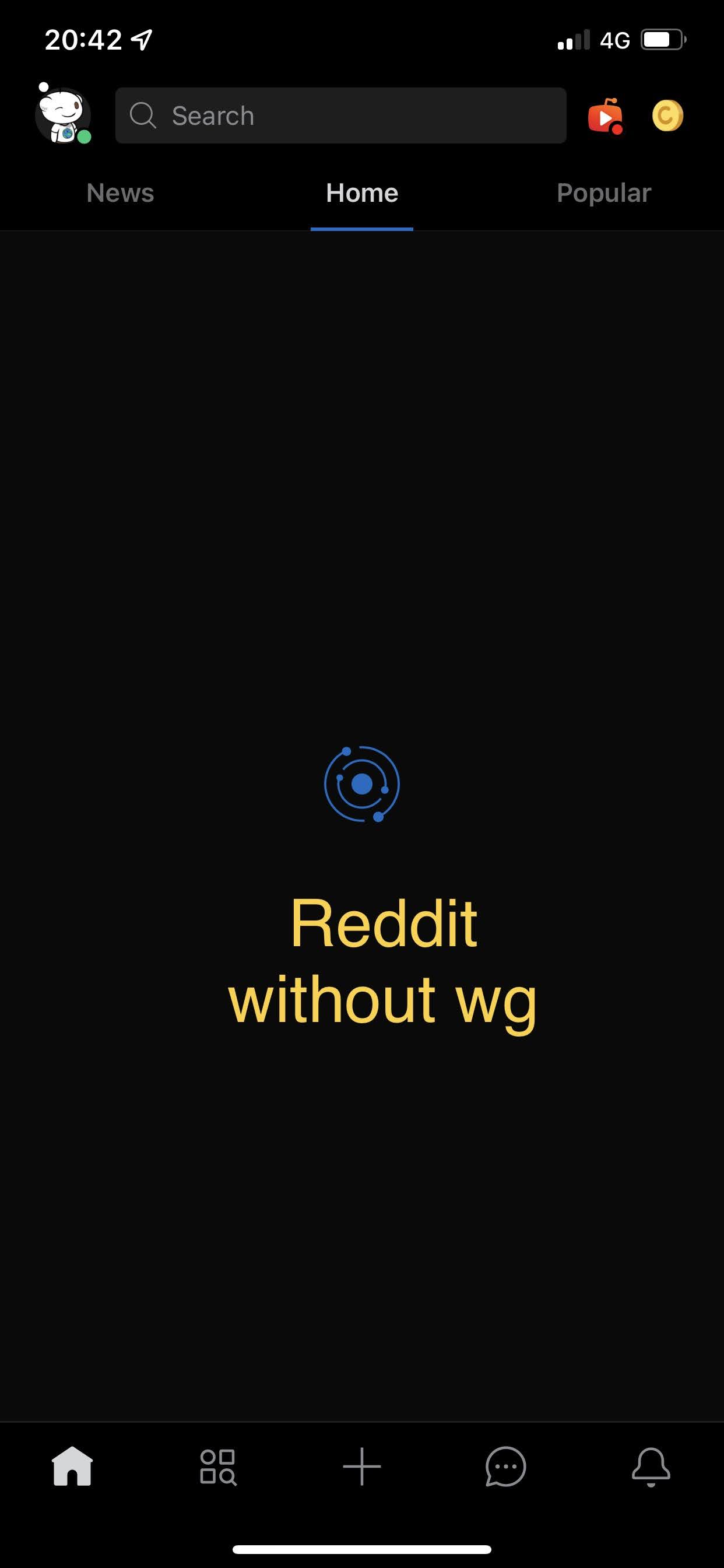

I have a question regarding WG.
I configured MT to MT WG. It’s not a Site to Site. using to bypass the ISP FW With the mangle/NAT rules.
Problem:
Routes are working fine (maybe:d). But I have a problem with the DNS query. It looks like some websites are opening as usual, but some don’t. some apps like Facebook and youtube will open. Reddit doesn’t.
I even checked some pornography websites some will open some don’t. As weird as it is for me it gets better. all of this test was with windows and IOS clients. I test this with a TV as the main reason for this setup is browsing youtube on TV. It didn’t browse any filtered domain at first, then I changed the DHCP Server DNS to /32 WG IP and then it opened youtube but still behave like other clients. some domains will do some don’t.
Can you guys shine some light on this? please.
Could this be an MTU issue?
update :d
Yes, it was.
Winbox can now access router , this is what preventing:
/ip service
set winbox address=192.168.88.0/24,192.168.40.0/24
Previously, It only had 192.168.88.0/24.
This one is also solved by adding the subnet on allowed address field.

Okay. yes, the correct fix was in the peer setting you stated.
If you had used 0.0.0.0/0 that would mean the client device would allow the subnet users or single user on client device (MT router or smart phone respectively) to be able to put in their destination, ANY IP address and the client wg interface would let it through. This is actually a typical scenario to allow those subnet or smartphone user to access ANY address on the internet through the Server Router.
Because its all addresses the more wide all inclusive 0.0.0.0/0 also includes all the subnets on the LAN SIDE of the Server router.
SO, to allow clients only to access the tunnel when looking to contact a specific subnet on the LANS side of the Server Router and not to any other subnets and not to the internet YOU DID THE RIGHT THING by stating 192.168.88.0/24
Correct on winbox access as well. It makes sense doesnt it.

@anav Thankyou. anyway, because I found my solution in one of your replays. all good.
@shafiqrahman if you have the issue too, check this I didn’t read all the posts I’m not sure if it’s your case or not but sounds like it.
http://forum.mikrotik.com/t/route-internet-traffic-mt-via-wireguard-tunnel-through-mt-wg-peer/154825/4
Sorry, for the delayed response.
0.0.0.0/0 in the allowed address in the client peer section resolved the facebook/reddit issue. I tried to left the field automatic, but that failed. Had to add 0.0.0.0/0 to make it work. @Sob this helped

    invalid
add action=accept chain=input comment="Allow Wireguard" dst-port=13231 \
    protocol=udp
add action=accept chain=input comment="Allow ADMIN to Router" \
    in-interface-list=LAN src-address-list=allowed_to_router
add action=accept chain=input in-interface-list=LAN port=53 protocol=tcp
add action=accept chain=input in-interface-list=LAN port=53 protocol=udp
add action=drop chain=input
    ipsec-policy=in,ipsec
    ipsec-policy=out,ipsec
add action=accept chain=forward comment="defconf: accept established,related" \
    connection-state=invalid
add action=accept chain=forward comment=" Allow Port Forwarding - DSTNAT" \
    connection-nat-state=dstnat
add action=accept chain=forward comment="ENABLE LAN to WAN" \
    in-interface-list=LAN out-interface-list=WAN
add action=accept chain=forward comment="ENABLE LAN to LAN" \
    in-interface-list=LAN out-interface-list=LAN
add action=drop chain=forward comment="Drop All Else"
Am I interpreting you correctly? :smiley:
Looks good!
