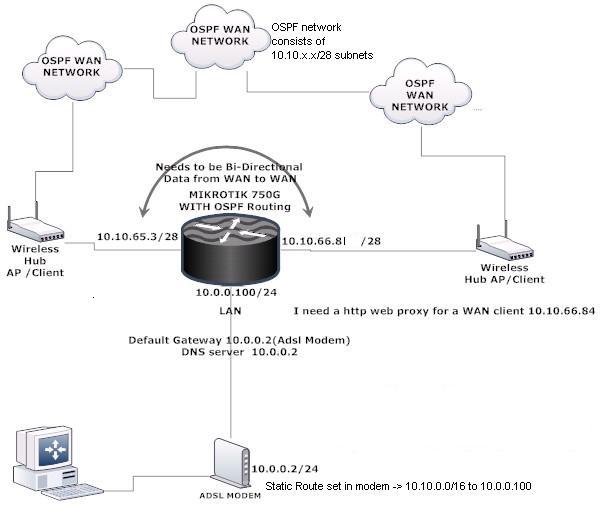

Hi, as a Mikrotik beginner I would like to learn how to set up on my 750G
. 2 WAN ports that runs OSPF between them.
. 1 LAN port that has a local ADSL internet link available on it, so devices on the WAN can web proxy to the mikrotik
. If someone can point out the steps that I need to work on I’d be happy with that e.g Set IP address, set static routes, set NAT/MANGLE etc etc..
But if someone can be in depth on the A-Z I’d appreciate that
Attached is a picture of what I want to do..
The WAN side is part of a bigger local Wireless city network!!

You’ll also need to correct the IP in your diagram (10.10.66.80.1 :stuck_out_tongue:)

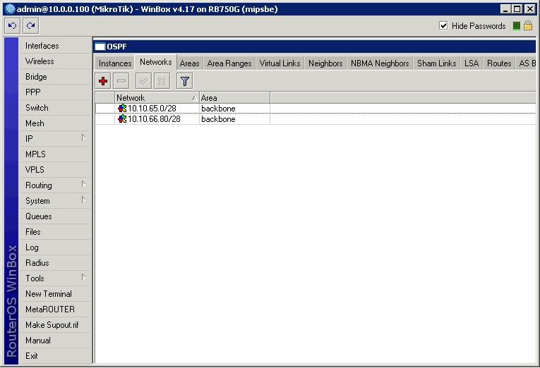

  1. Head to routing → ospf → networks
  2. add 2 networks to the backbone: 10.10.65.0/28 and 10.10.66.80/28 (i’m assuming this based on the bad IP, you’ll need to fix/confirm)
This will then allow dynamic creation of the interface broadcast settings and distribute any routes received on one interface back out the other.
Thanks for the tip omega-00I. I have fixed my diagram!

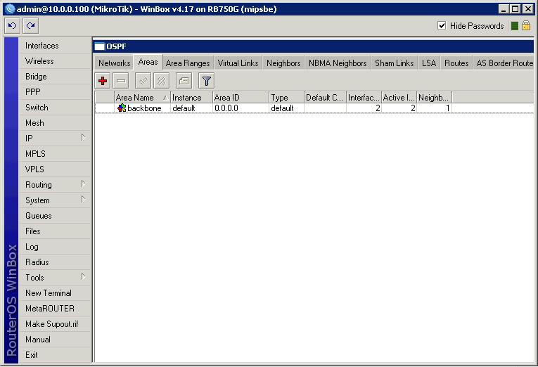

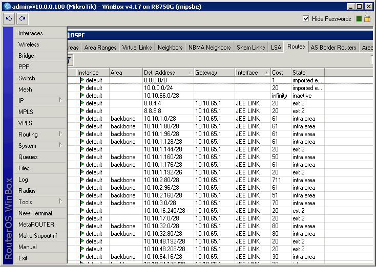

I think OSPF is generally working correctly as I am obtaining routes from other nodes now.

You should change the second network to 10.10.66.0/28 (based on the new IP address you’ve listed).

The WAN network address spacing was allocated to me by the people who run the Wireless WAN network. The WAN is broken up into /28 per IP block request. I was allocated the 10.10.66.80/28 block (80(network) - 96(broadcast), 81 to 95 usable). The other WAN on my link is from someone elses assignment, they staticéd me 10.10.65.3/28, and the default gateway for there ospf was 10.10.65.1/28
Yes I’m not advertising nor plan too that of my own LAN side via OSPF, so yes I think I will look further into dst-nat as a solution to pass those basic traffic types..
Cheers.
Lol ok, your updated network diagram was confusing me.. I thought it was just .8 on the end sorry. :slight_smile:
