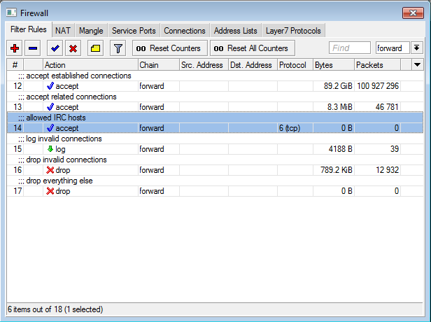

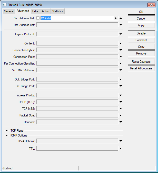

There is no such thing in RouterOS, a whitelist feature is something you have to create by yourself.
A whitelist feature consist of the following:
  • Address list.
  • Firewall rule that accept certain IP addresses from an address list (whitelist).
  • Firewall rule that deny everything else, otherwise a whitelist does not make sense.
Example of a whitelist feature:
Picture 1: The address list.
Picture 2: Firewall rules.
Picture 3. Where the address list is supposed to be added to the firewall rule.
MikroTik RouterOS process rules in the same order they are listed, from the top to the bottom. When a packet matches the criteria of any rules, then the specified action is performed and no more rules are processed in that chain (the exception is the passthrough action). A packet is accepted if it has not been matched by any rules within the chain.
