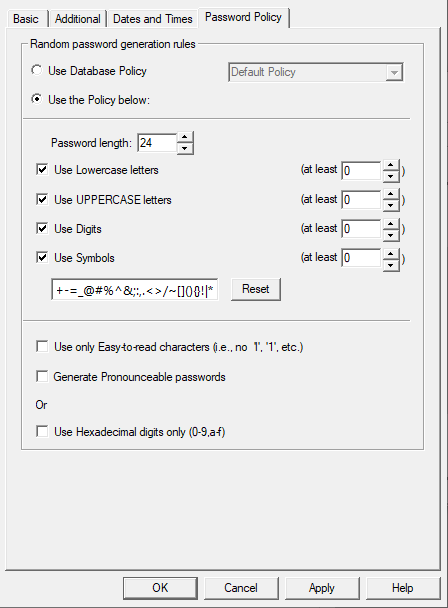

So, if you want to set good password, that can be used from ssh, console, winbox etc. with a password manager, set the password manager's "password policy" for RouterOS not to use ? \ " $ and most password managers probably won't use or or other non-printing characters.
I prefer not to have passwords that require special use cases (like quoting), because it can be very confusing when a password works with winbox, but does not from the console.
For example the following Password Safe should work?
