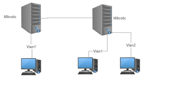

This is the task:
Rest the router to default as in Task 1 (this is the last time we reset the router)
Create 3 VLANs, with all of them needing to accommodate 253 devices. (use 192.168.0.0/16) have port 2 and 3 in VLAN 1, port 4 in VLAN 2 and keep a VLAN with no assigned port to it.
Connect your desktop to one of the VLANs and another desktop to another and make sure they can ping each other
Analyze the result
Now connect between the 2 mikrotic. So you should have the following physical setup:
Diagram
Test connectivity between the 2 Mikrotic by pinging from computer in VLAN 1 to the other one in VLAN 1’ and by pinging from VLAN 2 to VLAN 1 (Note VLAN 1 and VLAN 1’ are separate VLANs in our setup)(Hint [copy &paste on notepad to see hint]: routing is needed between the 2 Mikrotic you can do a simple static route )
I used VLANs 10, 20, 30 etc. instead of 1, 2, 3…

Hello everyone, does any1 has solution for the post above? Becasuse I§m facing the similar problem. I have Mikrotik with 10 ports. I’ve already configured DHCP for 3 different subnets 192.168.X.0/24, FW etc. But I found in 1 office I needed mikrotik too, because of lack of ETH ports :frowning: Is it possible to connect 2 Mikrotiks via 1 cable? And share VLANs? I’m not very experienced user. Thank you
Simple diagram:
Yes of course! Just set it up more like a switch aka no need for dhcp, firewall rules etc…

Thanks a lot! Finaly I managed to connect the routers. FY this video helps a lot: https://www.youtube.com/watch?v=4G0nIklG9Pw
Cheers!
J.
If by the video you mean setting up hybrid ports on MT routers, piece of cake!
The ether port is simply pvid for the port you wish to pass untagged in /interface bridge ports, and in /interface bridge vlan settings, simply tag the same etherport port for all vlan-ids needing to be sent tagged and for the etherport that was PVID ensuring its untagged for the associated vlan-ID.
